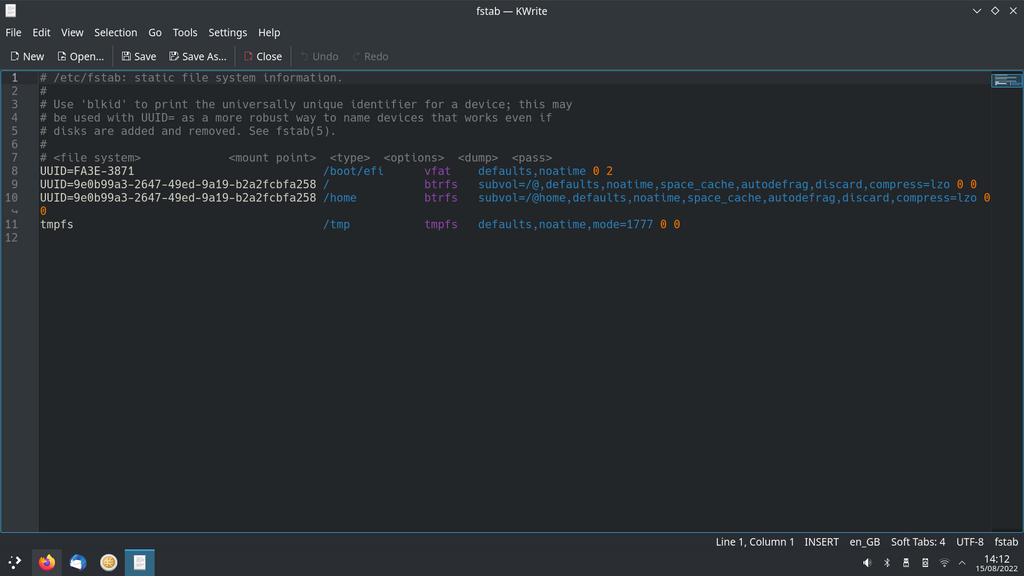

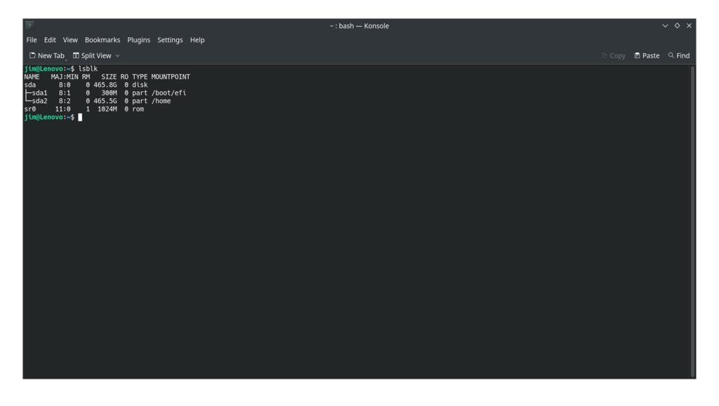

    Intended set-up was @/boot/efi and @/ (btrfs) as a learning exercise, admittedly years too late!
    I have no problems using the system and updates etc all run ok. Then I read about merging @/home into @/ but
    partition manager doesn't show @/home, which I took as meaning installation was just efi + root
    However ... lsblk doesn't show @/ and /etc/fstab shows both ?

    As said, everything seems to work but the above have me confused (nothing new there)!!

      "@" indicates btrfs file system volumes, not physical drive partitions. And mounts (things in fstab, for example) are not necessarily physical devices (which is what lsblk shows, and what partition manager ....manages) . Not sure how to define what a volume means tbh, other than they don't necessarily have a set size (other than the size of the partition they reside in), while physical partitions do.
      Use the mount command to view vastly more confusing info on all the things actually mounted, most of which are not physical devices at all.

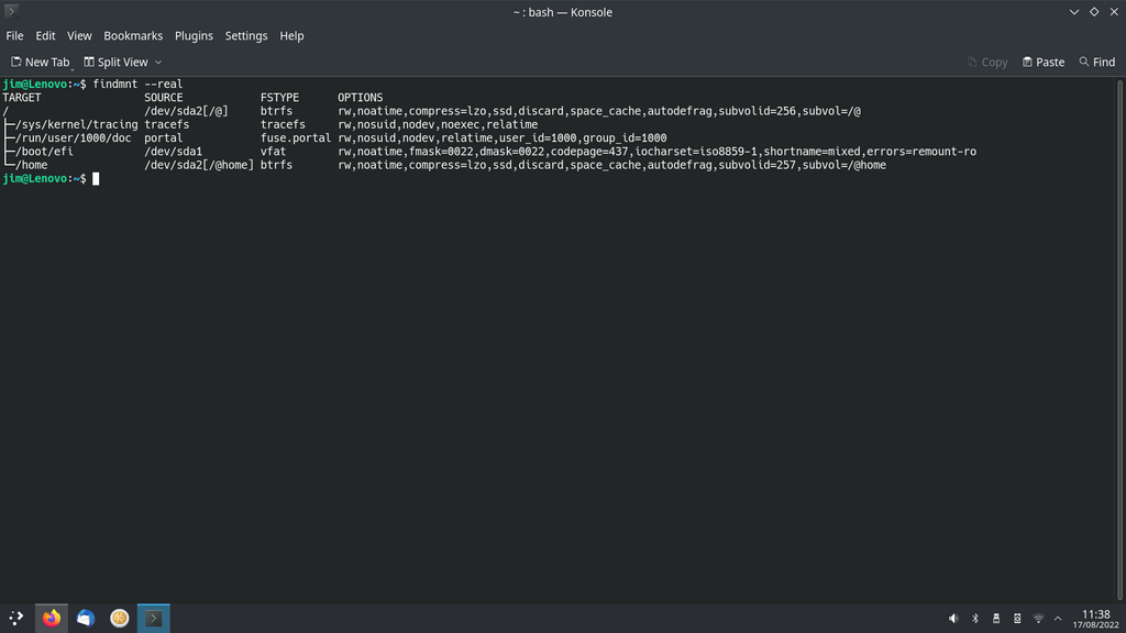

        For a somewhat less confusing list, one can use
        findmnt --real --types nosquashfs
        (nosquashfs is to suppress snap mounts; not necessary if you've got rid of snaps.)

            So I ran it and it seems I have a working system but apparently without root!!

            Downloaded Neon installation to usb and went through to partitioning which showed my ssd with /boot/efi and / only. Why /home appears instead I have no idea but assume a technical faux pas ( cock-up ) has been made somewhere.
            I assume simplest solution is to re-install but do it correctly?

              Um.... / /dev/sda2 [/@] btrfs <-----this is your root ("/")
              There is nothing wrong with your system . Both /@ and /@home are subvolumes that are sharing the available space on your BTRFS partition (/dev/sda2)
              Confusing and complex a bit, for sure, but you do not need to reinstall or anything.
                To add to what's been said re. btrfs, if you do a "df" to see your volume sizes, you will see that your root and home file systems have exactly the same "Filesystem" location (in your case /dev/sda2) and size-used-free amounts. This is how btrfs works using subvolumes.

                You access these subvolumes separately by virtue of the fact that they (the subvolumes) are mounted in the same way a file system is. So @ is mounted at / and @home is mounted at /home, and you never really "see" the subvolume names themselves except in /etc/fstab where the mount information is stored.
                A btrfs file system segregates data in the same way using two separate file systems does, except since the subvolumes reside in a single file system so all free space is shared across all the subvolumes - which explains why / and /home show the same exact sizes.
