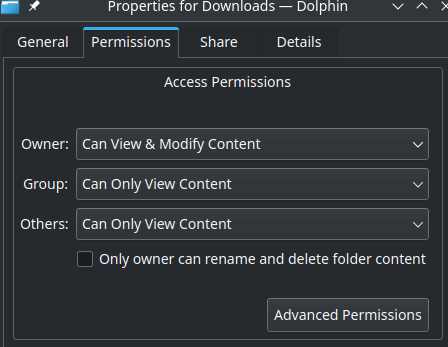

    Hello! I use kubuntu 22.04 and faced with permission issues. I have two problems:
    1. I use several ssd. One for Windows, one for kubuntu and one for file storage. File storage ssd have to use ntfs because I use it on both systems.
    Kubuntu mounts ntfs ssd automatically and it worked well, but currently something happend.
    On my ~/Downloads directory I can't create or update any files, can only read. By sudo it works.
    ~/Downloads is symlink to /media/username/storage/Downlods
    How is it possible if mounted ntfs should be opened for reading and writing?
    Permission in home directory:

    In Downloads:
    -rwxr-xr-x 1 username username    10776391 May 10 17:58 '_- 01-03s.webm'
    -rwxr-xr-x 1 username username   266042567 May 12 21:02 '_- 13-14s.webm'
    -rwxr-xr-x 1 username username  1993905105 Apr 28 23:18 '2024-04-28 23-08-27.mkv'
    -rwxr-xr-x 1 username username  2783989417 Apr 28 23:34 '2024-04-28 23-19-49.mkv'
    -rwxr-xr-x 1 username username  4402119728 Apr 28 23:58 '2024-04-28 23-35-24.mkv'
    -rwxr-xr-x 1 username username  1591175909 Apr 29 00:08 '2024-04-29 00-00-38.mkv'
    -rwxr-xr-x 1 username username  2619431880 Apr 29 00:36 '2024-04-29 00-22-53.mkv'
    -rwxr-xr-x 1 username username  2740307529 Apr 29 00:51 '2024-04-29 00-37-40.mkv'​
    Could you help? Previously it worked fine. I wanted to see configuration of mouning, but in settings I also have an issue. When I open System Settings -> Removable Storage -> Removable Devices it lagged and don't open the settings. I see only loading icon instead of cursor. Maybe these two problems are related.

    Hello! Sorry, I fixed the first one issue. I just change permissions in properties of the folder.
