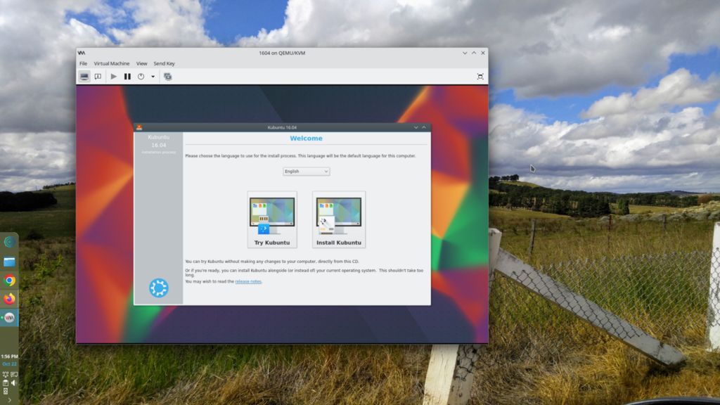

      Click image for larger version  Name:	Screenshot_20231022_135627.png Views:	0 Size:	751.4 KB ID:	674633

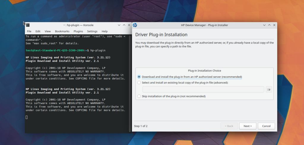

      But actually, you probably need the hp-plugin, which can be installed using a gui tool, when running the command
      hp-plugin
      Your scanner requires this proprietary plugin for scanning.
      This iirc is supposed to be installed when the HPLIP setup wizard is run, which you'd have to do in 16.04 as well.

          As I noted , you do need the plugin, I believe, based on that link I posted.
          Run the command hp-plugin as it mentions, to open the GUI tool to install it.
          You might also consider installing the whole HPLIP-GUI suite, which I think runs this, or can run this when its setup wizard is configuring things.
          This is just a suggestion for an available option, iirc you would have to install the plugin on a new 16.04 install as well fore the scanner to work.
          Another option, as I mentioned, is to install 16.04 into a virtual machine with Virtualbox, which runs 16.04 from your running 22.04 OS. It is easier for some, since you don't need to reboot, but is a bit of extra work and configuration up front, passing the printer, and sharing directories between the OS and the VM.
          As to the dual boot, we need more information to be able to determine what you problem with that is.
          What do you see, or what happens when booting the 16.04 installer? Which tool did you use to create the USB stick?

                          Yes, hitting 'd' at his prompt would do that. This is basically what the GUI would be asking you, and then doing.
                          What happens when you use Muon to try installing python3-pyqt5?
                          That package would allow the GUI to open, though it isn't necessary for the task at hand, as you can still install the plugin via this command-line process.
                          Installing the full HP printer suite may be useful as well, hplip-gui.
