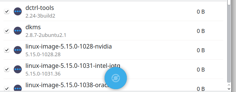

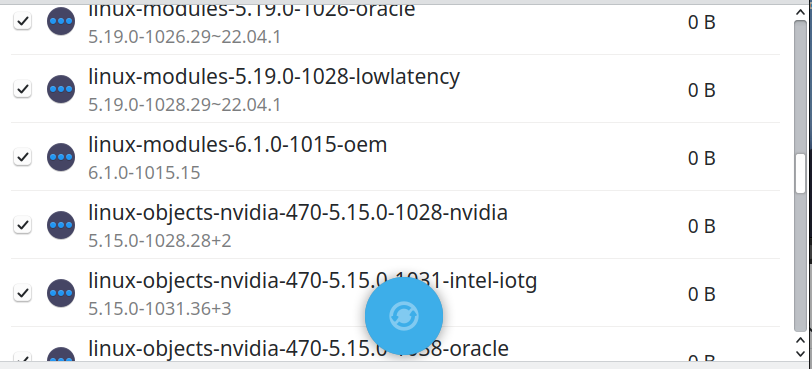

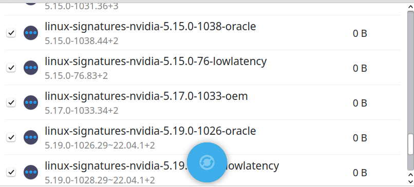

    I have a problem with kernel updates. I'm currently using kernel 5.15.0-76-generic.
    The update system showed me a lot of them. After installing them (possibly I shouldn't have) I could no longer boot.
    Click image for larger version  Name:	modules1.png Views:	0 Size:	47.8 KB ID:	671862
    Click image for larger version  Name:	modules.png Views:	0 Size:	74.9 KB ID:	671866
    Click image for larger version  Name:	modules3.png Views:	59 Size:	75.2 KB ID:	671868

        All of these updates were released through the Discover and they keep showing up as updates (I don't know if there is a way to cancel them so that they are not shown every time there are updates).

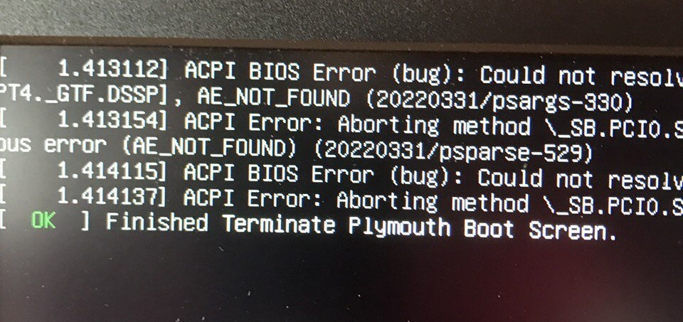

            But when it tries to boot with the new kernel it gets stuck again and I have to reboot and boot with an old kernel.
            The bios "errors" are always displayed when the system boots up.

              ACPI errors are "quite common" due to hardware manufacturers not following standards, actually having errors in their firmware or a regression in the Linux kernel - if everything works concerning ACPI it is common practice to simply ignore them. Sometimes a UEFI/BIOS update or a kernel update can correct them.
