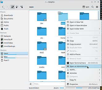

    Plasma 5.27, via kio-admin, is the method that they have come up with that works, after a number of false starts, maybe some dead ends, and devs giving up/leaving/moving on from working on it.

      I'm in /boot, I try to open /efi (like rt-click), but do not see any 'open as admin' option ...
        Also, "show full path" doesn't stick -- it works only once; I close Dolphin, open it, but then have to right-click on the URL bar and set "show full path" again (so I can see "/").
          Plasma 5.27, via kio-admin, is the method that they have come up with that works, […]
          You can also install/use kio-admin in Kubuntu 22.04 for Plasma 5.24 if you enable the Kubuntu Backports PPA.
                          As I (unclearly) mentioned, this is in Plasma 5.27, so in the upcoming Lunar release.
                          But......
                          I do not think so- I don't see it anywhere. oops I found it
                          Plus, adding the PPA to 22.04 will also upgrade all of Plasma and KDE stuff to 5.25. Which to me is a Good Thing.
                          5.25 is still a Good Thing, 5.27 even more so.
