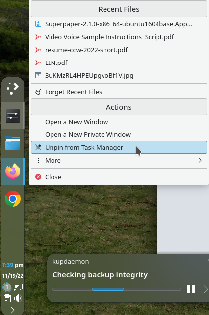

      Right click the icon, and unpin the icon to remove it.
      Click image for larger version  Name:	Screenshot_20221119_193915.png Views:	0 Size:	192.1 KB ID:	666708
      'Pinning' the application gives it this 'disappearing' act, as the default task manager style is the icons-only type, which would otherwise show duplicate icons.

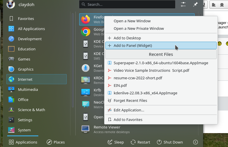

      Now, what you want to do is replace the icon by going into your Application Launcher, and right-clicking on the desired program icon, and selecting "Add to Panel"
      Click image for larger version  Name:	Screenshot_20221119_194432.png Views:	0 Size:	212.8 KB ID:	666709
      In this case you will need to go into 'panel edit' mode to move these icon widgets to where you want them. Pinning allows for drag and drop within the Task Manager area, and, just like in 20.04, widgets and icons need you to go into the panel edit thingy mode, but you can move them wherever.
