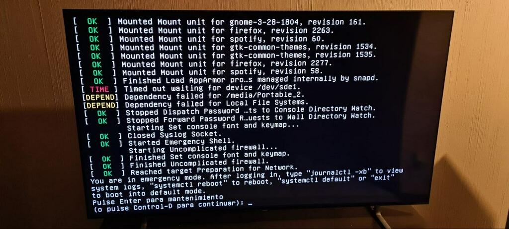

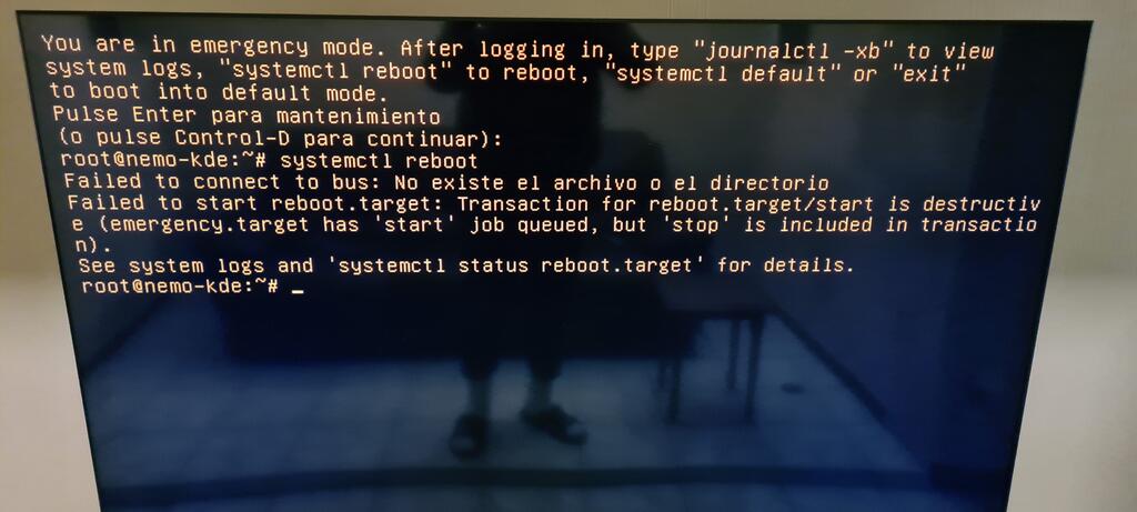

    This morning I booted as usual my Desktop where Kubuntu 22.04 is installed, and an HD check started, as randomly happened in the past, with no issues. This time took long to do the check, and I got into an "emergency mode" screen with several options to be typed in a command line. One of them was reboot, and I got an additional error (image attached).
    I have 3 partitions; one for data, one for Kubuntu boot, one for Linux Mint boot. I booted from Mint, and there was no problem; I could access the data partition.
    Doing further research, trying to boot from previous kernels on safe mode, I find that the problem is on an "sde1" device, yet for my phisical HDs (externals and internals) there is no sde1 device; any ideas?

      It could have something to do with a removable storage device ("/media/Portable_2"). -> "Dependency failed…"

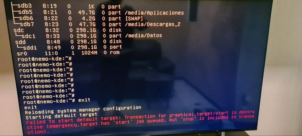

        Executing lsblk, I get this... with additional severe messages

            https://www.kubuntuforums.net/forum/...default-target
            Check the fstab for removable drives, or ones no longer present
            Also run an fsck on your drives - it may have errors. Use the recovery menu from Kubuntu's grub, or a live usb. Another OS is ok, but one that is using a different drive.
            A super quick search for "failed to start default target transaction for graphical.target/start is destructive" brings up both of these as possible issues.

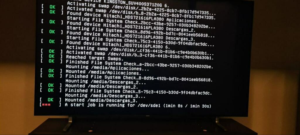

              When booting in safemode, it seems to force a "start" job on "sde1" (first screen)

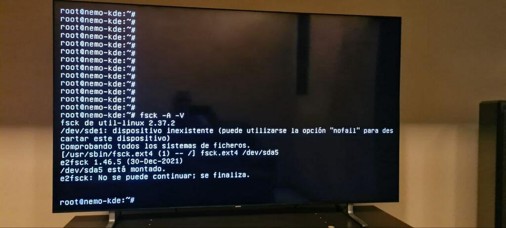

              Then, executing "fsck", is reporting an unexistent "dev/sde1" (second screen)
              As mentioned before, when listing all devices, no sde1 is present, so why is it trying to find an sde1 in the boot?

                'sde" can change, and if it failed to mount, or if it is not present, it won't show, obviously.
                But if sde is referenced in your /etc/fstab......it gonna look for sde.
                So boot to a live USB or a different OS and look at the contents of that file. You most likely have an entry there added for some drive that no longer is there, or is no longer seen as /dev/sde
