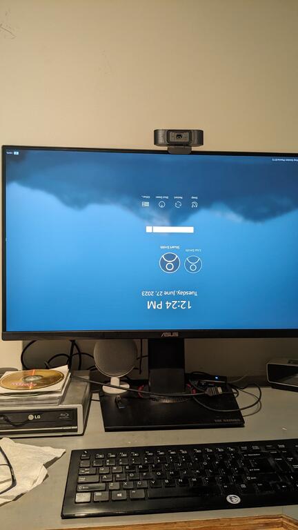

    Pardon me, I'm new into Linux. Due to some weird quirk, i mounted my monitor upside down. I could rotate my main screen, but the first login screen still showing on normal position. I tried to rotate it from this instruction. But no avail after restart and logout. Only at lock and sleep (after login) which they display on the right orientation. Any idea of how to rotate first login screen?
    For what i did on that instruction :
    1. Accessing /usr/share/sddm/scripts/Xsetup
    2. Paste the rotate command directly at very bottom of the line and save
    3. Accessing /var/lib/sddm/state.conf​ via vim and paste the trigger command at the very bottom (X11 blablabla), save
    https://askubuntu.com/questions/1254...n-screen-20-04

      can you show what you discovered and used for the command to rotate the monitor? Can we assume that it works when you run it manually?

        Going to the Arch Wiki/Manpages (as always), this works:
        Edit "/etc/sddm.conf" and add this:
        [X11]
        DisplayCommand=/usr/share/sddm/scripts/Xsetup
        Note that if the [X11] section already exists, just add the DisplayCommand line below it.
        Edit "/usr/share/sddm/scripts/Xsetup" and add this:
        xrandr --output DisplayPort-0 --rotate inverted
        Note here that "DisplayPort-0" is the monitor name on my system. Enter "xrandr" into a konsole terminal ​and find the name of your monitor. It will be the first "word" on the second line of the xrandr output.
        Reboot and this is the result:
        Click image for larger version  Name:	PXL_20230627_162448832.jpg Views:	0 Size:	32.9 KB ID:	671726
        Obviously works as requested. I suggest undoing all other edits you've done and try the above.​

            […] Reboot and this is the result:
            I am feeling a bit seasick now…
