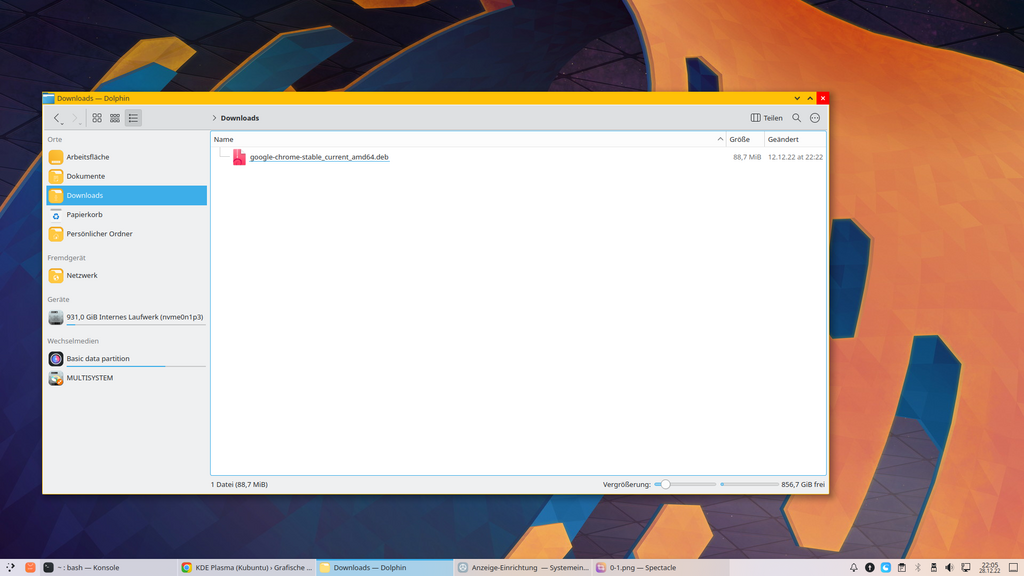

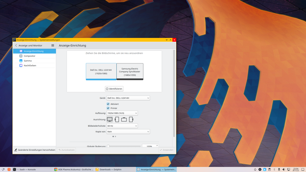

    • [0-0] Default monitor arrangement as the system it detects (in RL the order is different, Dell - right, Samsung - left)

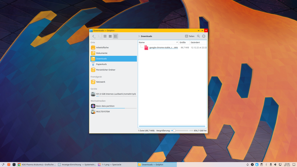

    • [0-1, 0-2]. All kde application, e.g. terminal, dolphin, etc. keeps their correct sizes and positions

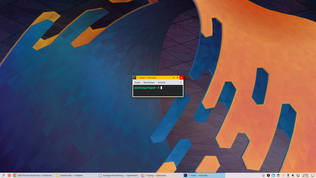

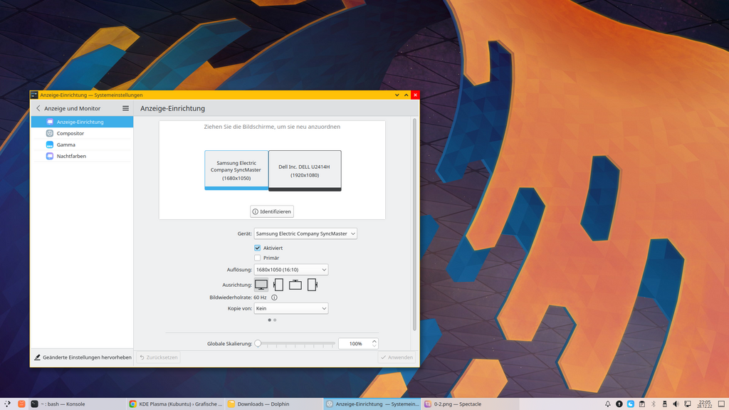

    • [1-0] !BUG! After a rearranging the monitors to a correct order
    • [1-1, 1-2] size & position won't keep as expected
ID:	667453 ​​​​​​​ Click image for larger version
