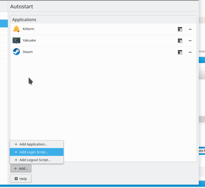

                      I like to be able to automatically run Bleachbit at shutdown, so the next boot is not slowed down by all those junk files.
                      This is present in newer Plasma versions, and is not specific to any distro. IE the addition or lack of Plasma specific features in Neon will soon be seen in Kubuntu. 21.04 has the current major version at the moment, same as Neon.
                      It is however, not clear to those used to the previous UI:

                      No idea if the logout option ever went away, can't recall noticing that part.
