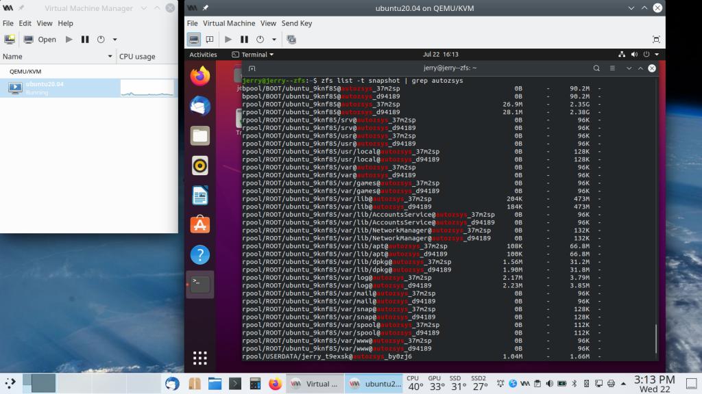

          The first thing I did after I got Ubuntu 20.04 installed was an apt update and full-upgrade. I had read that zsys, Ubuntu's version of Snapper, creates snapshots before apt is run. When I opened a terminal and did "zfs list -t snapshots" what I got was a couple dozen snapshots with cryptic names. I purged zsys because I want to do the snapshots manually, and when I want to do them.
          Notice the cryptic names. Obviously, no one can relate any particular snapshot to a particular file of set of files. The system does that for you. When you take a snapshot it makes an entry in grub which links all those files that compose your snapshot. In Ubuntu's version of zfs you cannot overwrite a running system with a snapshot. You have to take it off line first. That's why, to revert to a snapshot you must reboot and call up the grub menu, from which you can select the snapshot you want to use. How do you delete a snapshot and its associated snapshot files? I haven't learned that yet. I haven't learned how you select the collection of snapshots that allow you to rollback to a given point. Lots to learn.

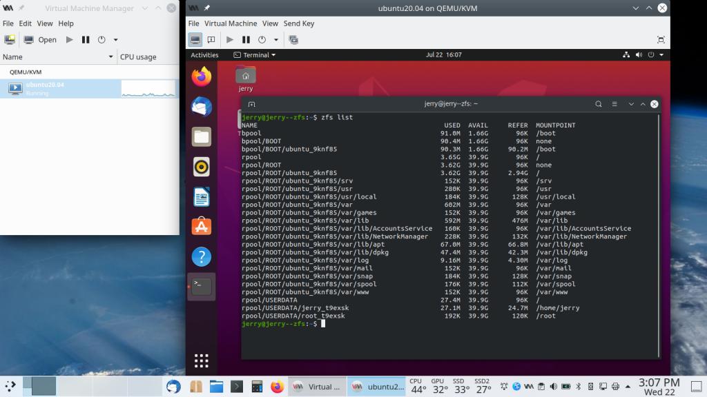

          I then did a "zfs list" to see the file structure.
          Viewing that pic you now know everything I know about Ubuntu's zfs file structure.

                        [B]ZSys is adding automatic system snapshot to GRUB menu[/B]
                        jerry@jerryZFS:~$
                        sudo zfs list -t snapshot
                        NAME                                                               USED  AVAIL     REFER  MOUNTPOINT
                        bpool/BOOT/ubuntu_cfgs2t@autozsys_[COLOR=#ff0000][B]hkcg8x [/B][/COLOR]                            0B      -     90.2M  -
                        bpool/BOOT/ubuntu_cfgs2t@autozsys_[B][COLOR=#ff0000]xw170v[/COLOR][/B]                             0B      -     90.2M  -
                        rpool/ROOT/ubuntu_cfgs2t@autozsys_hkcg8x                          58.4M      -     2.35G  -
                        rpool/ROOT/ubuntu_cfgs2t@autozsys_xw170v                          25.1M      -     2.35G  -
                        rpool/ROOT/ubuntu_cfgs2t/srv@autozsys_hkcg8x                         0B      -       96K  -
                        rpool/ROOT/ubuntu_cfgs2t/srv@autozsys_xw170v                         0B      -       96K  -
                        rpool/ROOT/ubuntu_cfgs2t/usr@autozsys_hkcg8x                         0B      -       96K  -
                        rpool/ROOT/ubuntu_cfgs2t/usr@autozsys_xw170v                         0B      -       96K  -
                        rpool/ROOT/ubuntu_cfgs2t/usr/local@autozsys_hkcg8x                   0B      -      128K  -
                        rpool/ROOT/ubuntu_cfgs2t/usr/local@autozsys_xw170v                   0B      -      128K  -
                        rpool/ROOT/ubuntu_cfgs2t/var@autozsys_hkcg8x                         0B      -       96K  -
                        rpool/ROOT/ubuntu_cfgs2t/var@autozsys_xw170v                         0B      -       96K  -
                        rpool/ROOT/ubuntu_cfgs2t/var/games@autozsys_hkcg8x                   0B      -       96K  -
                        rpool/ROOT/ubuntu_cfgs2t/var/games@autozsys_xw170v                   0B      -       96K  -
                        rpool/ROOT/ubuntu_cfgs2t/var/lib@autozsys_hkcg8x                  23.3M      -      475M  -
                        rpool/ROOT/ubuntu_cfgs2t/var/lib@autozsys_xw170v                   164K      -      475M  -
                        rpool/ROOT/ubuntu_cfgs2t/var/lib/AccountsService@autozsys_hkcg8x     0B      -      104K  -
                        rpool/ROOT/ubuntu_cfgs2t/var/lib/AccountsService@autozsys_xw170v     0B      -      104K  -
                        rpool/ROOT/ubuntu_cfgs2t/var/lib/NetworkManager@autozsys_hkcg8x     88K      -      132K  -
                        rpool/ROOT/ubuntu_cfgs2t/var/lib/NetworkManager@autozsys_xw170v     88K      -      132K  -
                        rpool/ROOT/ubuntu_cfgs2t/var/lib/apt@autozsys_hkcg8x              6.70M      -     73.0M  -
                        rpool/ROOT/ubuntu_cfgs2t/var/lib/apt@autozsys_xw170v               100K      -     67.1M  -
                        rpool/ROOT/ubuntu_cfgs2t/var/lib/dpkg@autozsys_hkcg8x             1.64M      -     31.2M  -
                        rpool/ROOT/ubuntu_cfgs2t/var/lib/dpkg@autozsys_xw170v             1.48M      -     31.2M  -
                        rpool/ROOT/ubuntu_cfgs2t/var/log@autozsys_hkcg8x                  1.21M      -     2.03M  -
                        rpool/ROOT/ubuntu_cfgs2t/var/log@autozsys_xw170v                  1.20M      -     2.09M  -
                        rpool/ROOT/ubuntu_cfgs2t/var/mail@autozsys_hkcg8x                    0B      -       96K  -
                        rpool/ROOT/ubuntu_cfgs2t/var/mail@autozsys_xw170v                    0B      -       96K  -
                        rpool/ROOT/ubuntu_cfgs2t/var/snap@autozsys_hkcg8x                    0B      -      120K  -
                        rpool/ROOT/ubuntu_cfgs2t/var/snap@autozsys_xw170v                    0B      -      120K  -
                        rpool/ROOT/ubuntu_cfgs2t/var/spool@autozsys_hkcg8x                   0B      -      112K  -
                        rpool/ROOT/ubuntu_cfgs2t/var/spool@autozsys_xw170v                   0B      -      112K  -
                        rpool/ROOT/ubuntu_cfgs2t/var/www@autozsys_hkcg8x                     0B      -       96K  -
                        rpool/ROOT/ubuntu_cfgs2t/var/www@autozsys_xw170v                     0B      -       96K  -
                        rpool/USERDATA/jerry_r7h6kl@[B]autozsys_[COLOR=#ff0000]n6xia1[/COLOR][/B][COLOR=#ff0000] [/COLOR]                       208K      -     1.68M  -
                        rpool/USERDATA/jerry_r7h6kl@autozsys_hkcg8x                        184K      -     1.72M  -
                        rpool/USERDATA/jerry_r7h6kl@autozsys_xw170v                        620K      -     1.80M  -
                        rpool/USERDATA/root_r7h6kl@autozsys_hkcg8x                           0B      -      112K  -
                        rpool/USERDATA/root_r7h6kl@autozsys_xw170v                           0B      -      112K  -

                          Oshunluver, you'll LOVE this aspect of Ubuntu's version of ZFS
                          https://didrocks.fr/2020/06/11/zfs-f...tition-layout/
                          GRUB is the bootloader global to your machine: it means that you can have multiple OS installed in parallel, ruled by the same and unique GRUB instance. Thus, GRUB should be installed on a fixed partition: There is no need to version its content (save its state), boot from an older GRUB menu or flip-flap between multiple, parallel GRUB instances installed on your system in case of multiple machines.
                            Zsys is Canonical's equivalent to SUSE"s Snapper. I have spent the evening focusing on zsys (zsysd) and zsysctl, trying to learn how to mix my manually made snapshots with those made by zsys.
                            I found this article on GitHub and it shows that zsys is still hot out of the oven, one might say even half-baked. People are having lots of trouble due to filling up the 2GB bpool with too many snapshots and syslogs with too many error postings. They are also losing terebytes of data when, during boot, their datasets are misinterpreted as unauthorized snapshots and deleted. IOW, snapshots manually made by the user or admin are not being picked up well by zsys. First introduced in 19.10, zsys is still in such a state of flux that people installing Ubuntu to take advantage of ZFS may be well advised to remove it and zsysctl, or at least disable and mask them. That's what I'm going to do.
                            I'm going to continue playing around with ZFS on my virtual Ubuntu, but without the "benefits" of zsys. I'm sticking to pure ZFS commands. Perhaps Canonical would be well advised to make the installation of zsys and option on the installer so that people don't get splashed with automatic snapshots out of the gate.
