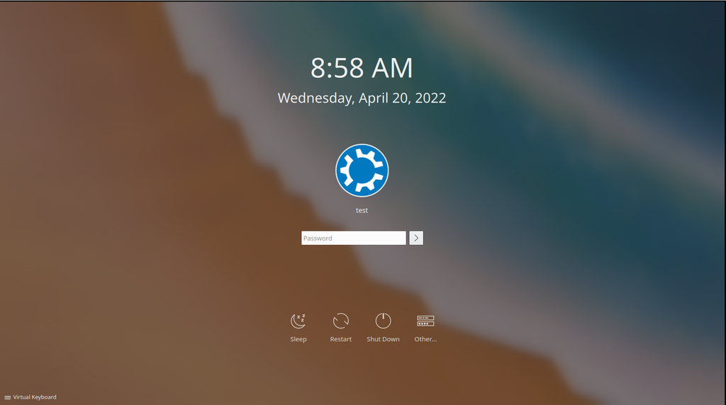

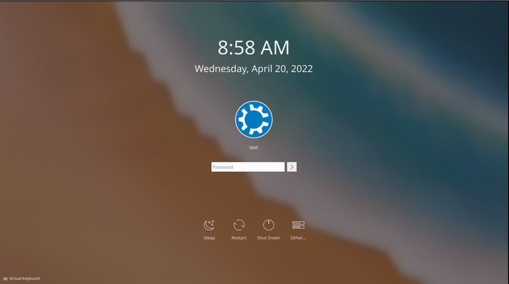

My first thought was that your computer was actually shutting down/rebooting, considering that *all* your open applications closed.
The lock screen will look quite identical to the login screen, using default theming and settings. But the actual login manager --SDDM is unrelated and is a separate thing from the lock screen.
I believe that by default, resuming from suspend does in fact lock the screen - requiring you to enter your password to open it back up.
It is the same screen you can get if you leave your system idle for some period, or manually lock it (Meta-L, or the right-click desktop menu)
The login manager screen provides you with more/different choices:
The lock screen will have only password block, switch user as options

That was the lock screen prompt. If you don't like getting that (I don't), system settings, workspace behaviour, screen locking, uncheck the "Lock screen automatically" boxes. One can still lock the screen with a shortcut, default Ctrl-Alt-L. And, you can make its appearance distinctive there.Originally posted by Jesse Weil View PostI did have to Login however, so I guess I got the Login prompt.
