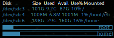

    So now, (after deleting the backup home folders), I have
    On K20, and

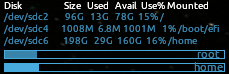

    on neon.
    Which means I'll be able to recover quite a lot of space from both /roots if I need to :·)
