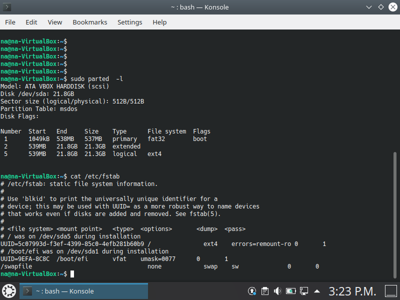

    HAs anyone here done a recent install of 20.04 in legacy mode where you let the installer auto config everything to an empty drive?
    I tried it with a couple of Ubuntu derivatives and for some reason it creates a fat32 partition and mounts it at /boot/efi (Ubuntu MAte and Linux Mint).

    Yup. Samething in Kubuntu. Seems to be a ubiquity bug. Will have to try a distro that uses Calamares:

      I am gonna guess that Ubuntu uses the /efi partition as the /boot partition for legacy installs, to stash grub's files perhaps? Note that there is no content in /boot/efi as there would be on a uefi install. I imagine it would simplify things, especially with install options that might require this, like ubuntu's optional zfs, or btrfs, or encryption (maybe?).

                Ok so I took my VM with installed kubuntu 20.04 and forcibly destroyed the fat32 partition and removed the entry from fstab.
                Successfully rebooted the machine with no issues. So clearly grub does not reside in that little partition.
                The only reason I can think of for teh existence of that partition in a legacy install, is to have a primary partition of some sort on the disk. This would allow the creation of an extended partion behind it which can contain the entire Linux installation. For some reason ubiquity now places the whole install inside an extended partion within a logical partition.

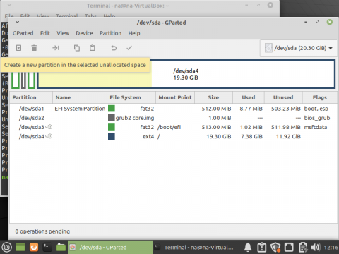

                    You want to see more wonkiness?
                    In the event that you install in legacy mode on a GPT disk, you need to create biosgrub partition which containes the core image.
                    So I took gpt disk that had an efi install already. Switched the boot mode back to legacy. Asked the installer to do a full erase install. Here is ther result:
Name:	VirtualBox_Mint XFCE 20_12_07_2020_12_16_00.png
                    It left the old EFI partition from the UEFI install. It created a new fat32 partition which it decided to mount at /boot/efi. And then it shoved in grub in between the two.

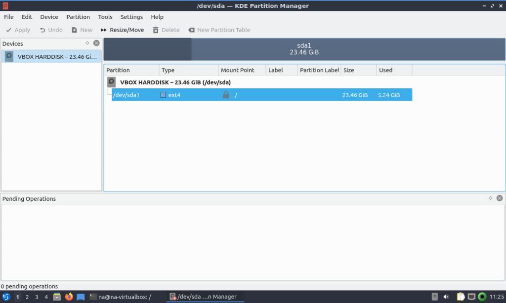

                      So good news is Lubuntu 20.04, which uses QT and the Calamares installer has retained some sanity. It also explicitly shows you the boot mode (legacy/uefi) and partition table (msdos/gpt) in install screen.
                      Looks Neon is safe from this. ANyone want to try Pop OS? It uses it's own installer and the systemd bootloader, not grub.
