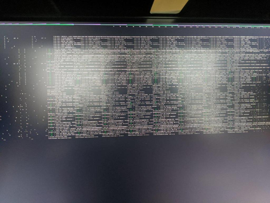

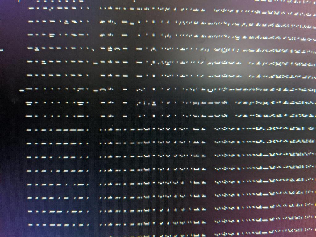

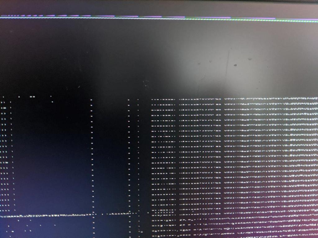

    So I have created a USB Boot disk and try to start up my system with it. I get to the menu, and select the try kubuntu option, and then bad things happen. Basically a bunch of unreadable text happens, and then it just stops. I have posted pictures. I have 3 monitors, one 4k, one 1080 monitor and one 1080 tv display (display port, display port, hdmi, respectively). So I tried again but first disconnected the 4k and TV. Same thing. Changed the 1080 monitor to a different display port output on the card, same thing.

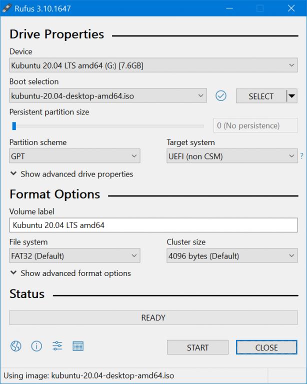

    Secure boot is off. I had this happen immediately after I built this PC about a month ago, but had to rebuild it. Last time all I did was recreate the boot USB, which I did again this time (did a fast format from Windows before building it).

    BillRClick image for larger version
ID:	649639Click image for larger version
ID:	649640Click image for larger version
    It could be either a) your NVidia Graphics or b) the version of the live installer (also could be "and", though…).
    a) try booting the installer with the second option "Start Kubuntu (safe graphics)"
    or (and?)
    b) try the latest daily build of the Kubuntu 20.04 live installer: http://cdimage.ubuntu.com/kubuntu/fo...-live/current/

      Most likely, either your ISO isn't good or Rufus did a poor job. Check the ISO sha256 checksum, if it's good, download install and use Etcher instead, and try again. I did write a post on here a while ago on how to verify an ISO after it's been burned to a USB stick, but it's not trivial.

        Using "safe graphics" worked. Thank you.
        I wonder why "safe graphics" isn't the default mode.
        Etcher didn't work when I first installed it, but did after reboot to Windows. Fortunately I didn't need to redo the install as it was the graphics setting. Thanks for the help people.
