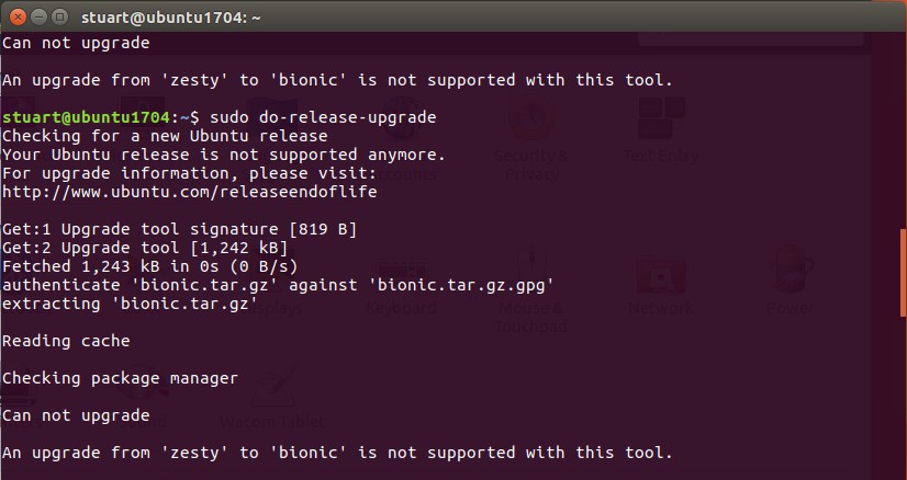

          For giggles, I installed Ubuntu 17.04 (can't find Kubuntu) and ran the release upgrade:

            I would think with that degree of separation, you may as well just have your cousin download 20.04, backup his current data, and walk him through a clean install exactly once!
