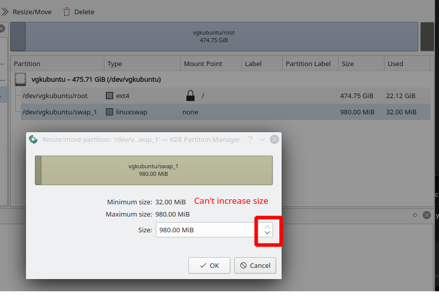

    I've installed Kubuntu 20.04 with LVM/encryption, and found out that the installer created a 1GB swap volume (not a file), even though my laptop has 16GB of RAM, and I installed Kubuntu onto a 512GB SSD.
    Why wasn't it an option during the installation process, to specify the swap size? Why make a swap volume (which is a pain to resize), instead of swap file, which is very easy to resize?
    I do development work and I need 8+GB of swap. Since there's already a swap volume, I don't want to create a separate swap file. But resizing the volume isn't possible, because the root volume is mounted.
Name:	Can't resize swap volume.png
    Do I have to shut down my system, boot from another device, mount my encrypted volume, then hope I can resize the swap that way? Is there no easier way? lvresize didn't work, and the kvpm GUI has been discontinued after bionic.

        I've resized the swap partition by booting KDE Partition Manager from the Kubuntu image. Then I booted from the SSD and ran `swapoff`, `mkswap` and `swapon` to make the swap use the new larger size.
