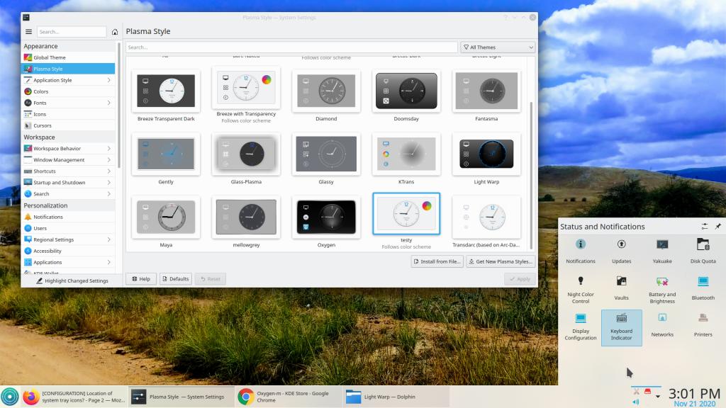

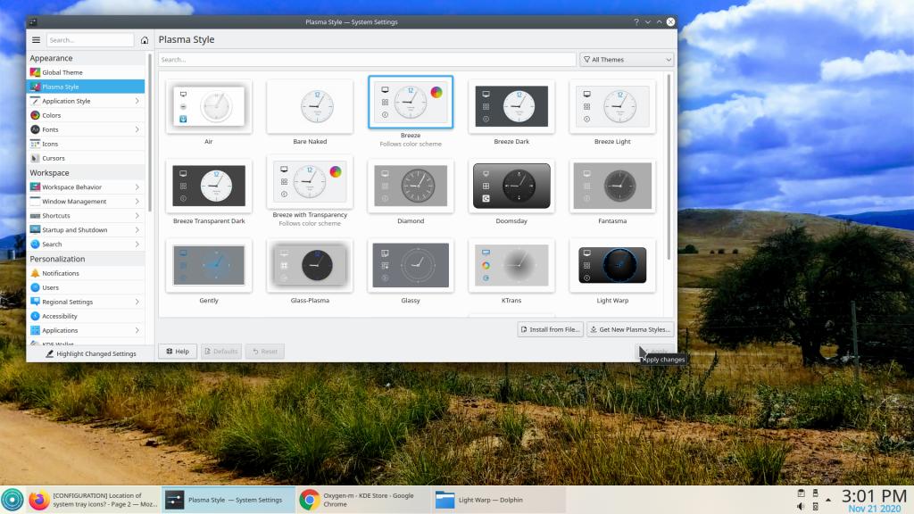

                          Here is a quickie example. I copied the 'default' folder from /usr/share/plasma/desktoptheme/ and copied to the corresponding place in ~/.local/share
                          (this may be different in Kubuntu, which uses a custom style as 'default', for me the 'defualt' is the stock white-grey KDE breeze style)
                          I named the folder 'testy', edited the .desktop file inside it to match the name. I copied the icons folder from a theme called Light Warp , and used that to replace the icon folder in the Testy folder
                          Stock theme

                          Slightly colorful systray icons stolen from a different theme
                          Mere moments to do.
