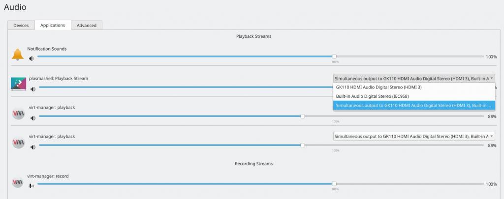

          Based on that last screenshot, your sound card isn't installed:
            I see. Is there any fix ? I am able to play sound from music and movies.
            Thanks.
              I managed to move the slider to 100 %. Now I can hear login and logout sounds. Thank you.

                              I had to turn on in Pulseaudio, Playback/Systemsounds. Interestingly, in Audio Devices/speakers shows (Built-in Audio Analogue Stereo), whereas Applications/Notification Sounds doesn't show any output.
