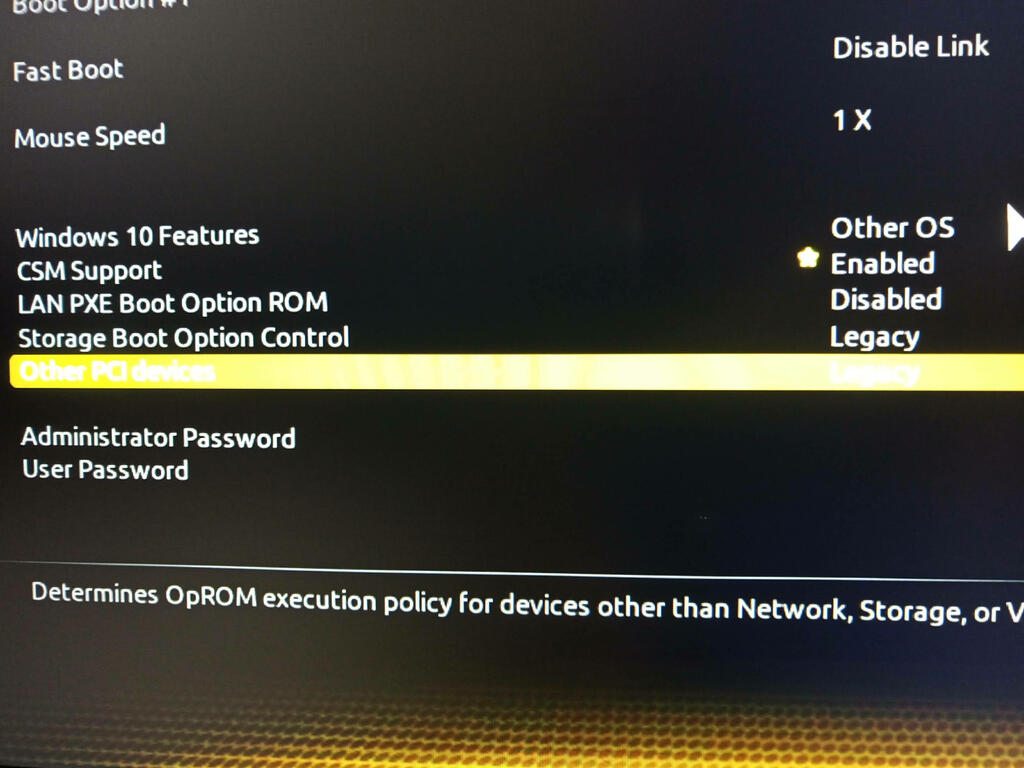

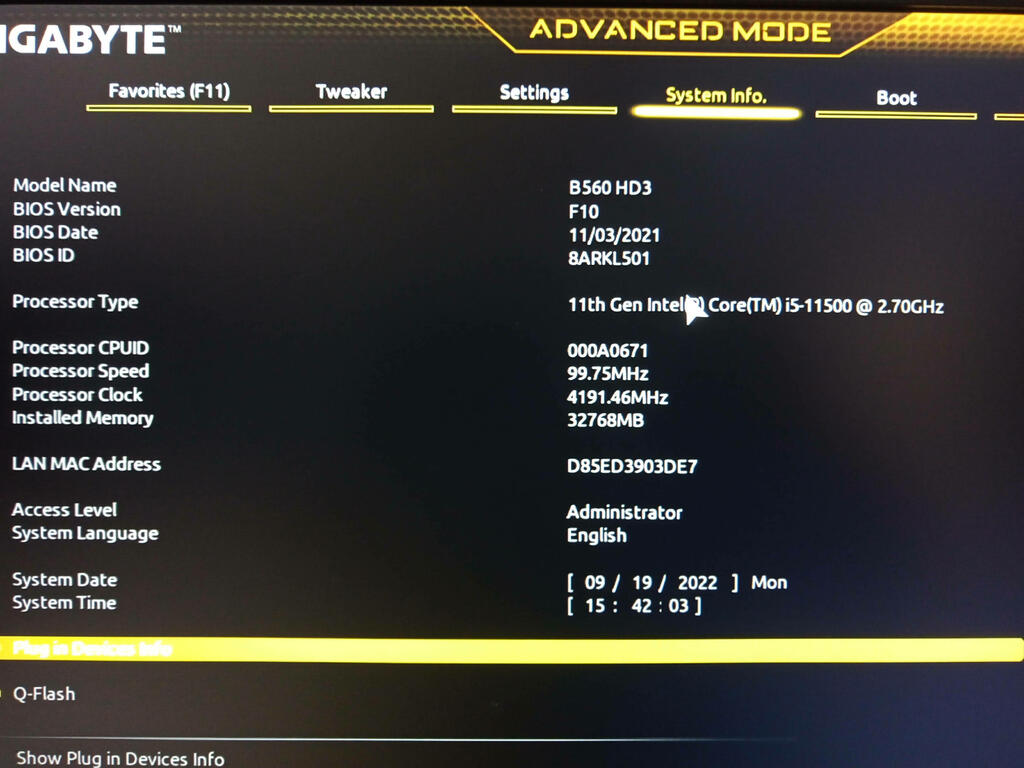

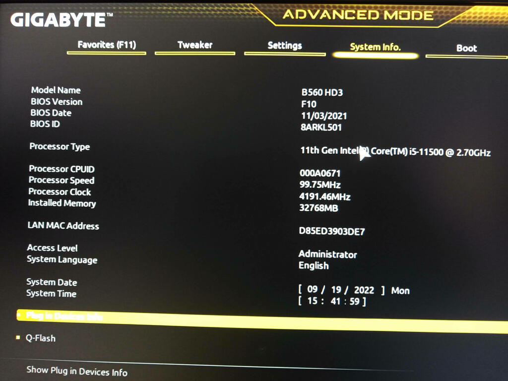

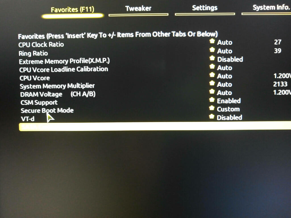

    SO the older PC finally died. It used UFEI booting. I know as I updateded it's UFEI BIOS once. No REesponse when powered on. i did breifly get it to respond after unpluging everything. (Maybe it's the boot drive??)
    Back to new motherboard. So the only screen I get is UFEI Bios, and it has more options than McDonalds has ever had. I finally found UFEI boot, it's has identified the ssd, every other hard drive is currently unplugged. I have a 12month old 23 inch PC screen and the TV via HDMI. Everytime I go through the ufei menu I keep finding new things. some that I have read onling don't exist and the ufei boot option was under to main menus. I cannot beliefe how difficult this is to get to work. Is all this new **** design for win10 only? Yes I have set OS from windows 10 to "other"
    any good starting points as I have a massive headache, and am totally pissed off at this plug and PRAY is not working.
    I've even changed the PSU as it wouldn't boot this morning, and foudn the issue to be the power switch connect onto the motherboard was disconnected.
    Please. I know I am asking a lot.

      Hm…
      Just two thoughts:
      - Does "Secure Boot Mode = Custom" mean that secure boot is disabled?
      - Are you sure "Legacy" is the correct setting for "Storage Boot Option Control"? I have my UEFI-BIOS set to "UEFI + Legacy (UEFI first)" as I use EFI-installations for my internal systems and Legacy-installations for some of my external system drives (I don't know how you installed yours, of course…).
        It may be that Secure boot needs to be off. Don't know what custom means. If you don't want to use Windows. Change the boot options to legacy and see if that works. I Take it it will not boot the live session?
          Are you trying to boot the old drive, or a usb install USB?
          Where is it failing, what exactly are you seeing as you power on, until it stops or fails?
          If you aren't using one, a live usb is always a good tool to test new hardware.
          If you are trying to boot your existing OS drive you might just need to fix grub, from a live usb using boot-repair.
          I just had to do this myself last night transferring my NAS drives to a new case and motherboard.
          Most all of the bios settings can be ignored, at least up front. If you don't have Windows you should disable secure boot unless you know that you used it for the install. There should be an option somewhere to use the defaults which will reset things
          But do tell or show us what is happening when you try to boot
          Hopefully, it is just a grub problem with the new mobo and boot repair can fix it
          https://help.ubuntu.com/community/Boot-Repair
          But more info will hopefully help narrow things down.
            Hm…
            Just two thoughts:
            Secure boot mode, if I remember (crap sleepless night) has two options. Custom, and I can't remember the other, but could be 'windows'
            Legacy. I was screwing around to see if the last time I formatted the boot drive it was under it's OLD machine which had/has a simple non-ufei BIOS.
            PROGRESS

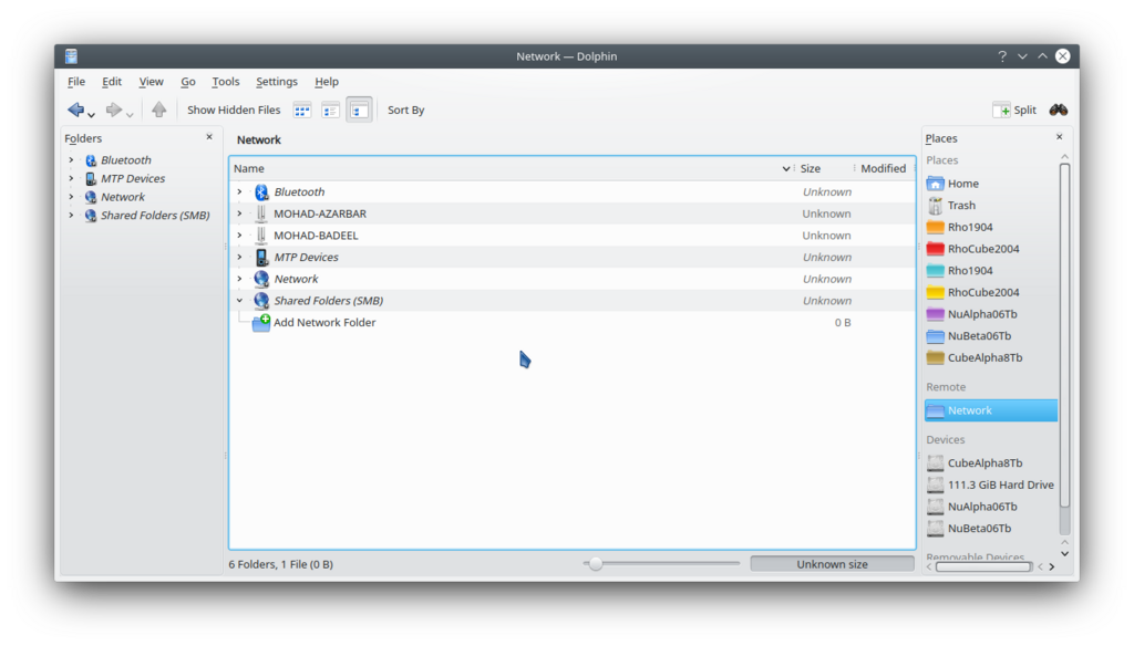

                Progress again. All HDD's Zpools are connected and working. EXCEPT 1
                This is ALL from the New B560 HD3 Motherboard, after I attempted to boot again with 20.04 USB plugged in, and somewhere, somehow it booted the USB without asking or given me the option to boot of external device.
                Click image for larger version  Name:	20220921_115916-NetworkError-01.png Views:	0 Size:	127.2 KB ID:	665297
                Error 1 shows NEW PC Networking access
                Click image for larger version  Name:	20220921_115916-NetworkError-02.png Views:	0 Size:	200.4 KB ID:	665298
                Error 2 Shows accessing a "shared" local drive. Access is Successful
                Click image for larger version  Name:	20220921_115916-NetworkError-03.jpg Views:	0 Size:	37.2 KB ID:	665299
                Error 3 is when I attempt to access the one and only shared drive that pops up this garbage. Any suggestions on what is going on, with this one share. SMB.conf has all shares (copy and pasted) and I just changed the name, and I've checked it 3 times.
                Click image for larger version  Name:	20220921_115916-NetworkError-04.jpg Views:	0 Size:	92.2 KB ID:	665300 Click image for larger version  Name:	20220921_115916-NetworkError-04.jpg Views:	0 Size:	92.2 KB ID:	665301
                Error 4 shows access a NETWORKED PC (the other computer) and a share on it. It is successful. Obvious the copy and pasted smb.conf file with some minor changes from this NETWORK PC to the NEW PC is working.
                Still why is one share being a total pain.
                Still work to do, but I must visit Dad in Hospital.

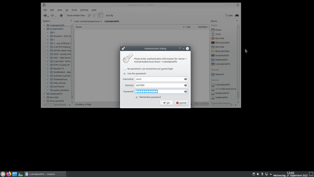

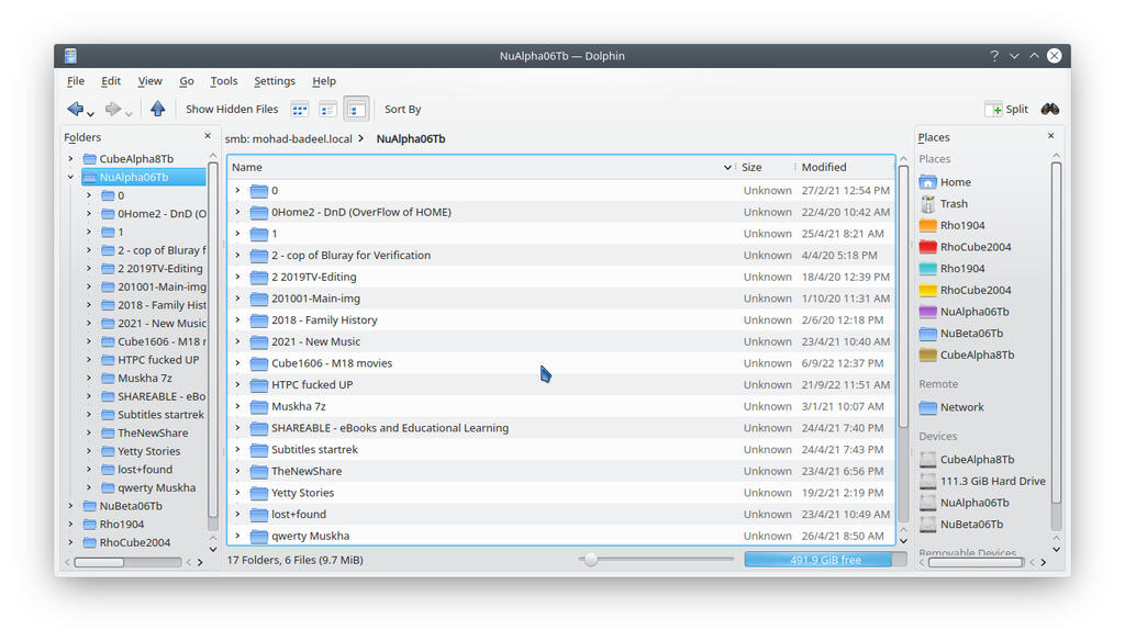

                  New Problem. Most Likely Samba related. I cannot write to the B560 HD3 Shared Drives from this my main computer.
                  I can read/write & delete files from any folder on any drive via the network option shown above as Error-01... This is the same for reading and writing from B560 HD3(HTPC) to this Main PC.
                  I fixed the error somehow with access to CubeAlpha8Tb. I had two one ended in Tb the other ended in TB and was root accessed only.
                  I've deleted the TB version, removed and reinstated Share on the other, and can now access CubeAlpha8Tb from both PC's
                  I have chown /media/mm3/ -R (this is where all the drives appear
                  AND
                  I still cannot WRITE or view MOVIE files from This MAIN pc on the HTPC pc. I can VIEW only.​
