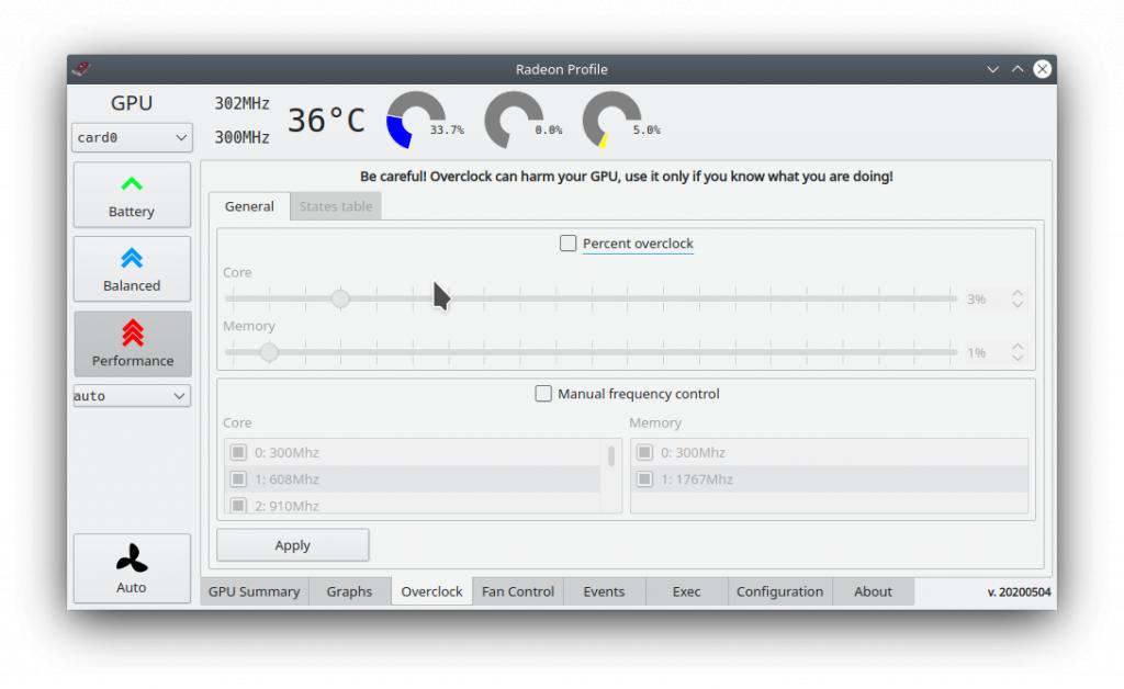

    Software - There is no 'official' GUI software like Nvidia Settings at all.
    I don't play with OC'ing much, so I use software called Radeon Profile
    This has basic overclocking sliders, and fan control, which was useful for me as my first 480 ended up being previously used for mining.
    Alternatives I have no experience with:
    https://github.com/BoukeHaarsma23/WattmanGTK
    https://github.com/Lurkki14/tuxclocker
    And of course there is the command line.

        I installed that software Clay. When I started playing with the fan speed I discovered if I select "Auto" a shrill noise comes from the fans! It's not related to the speed because I can manually select any speed with no noise.I had to reboot to make it go away. Super annoying.

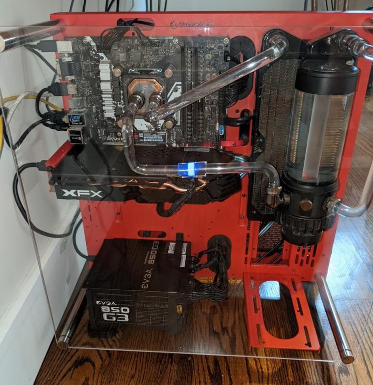

        Also annoying to a lesser degree: There's a bright blue LED right by the 8-pin power plug that's counter to my Aura color scheme - red "heartbeat". So far I have been unable to determine what it indicates if anything and how to turn it off. It sits right behind a water tube so it's magnified which makes it worse:

        Eventually I'll be re-doing that pipe and it won't be so close the the video card.
