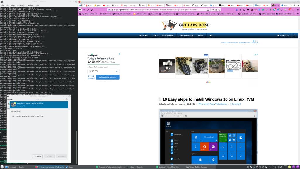

    I tried the instructions here : https://getlabsdone.com/10-easy-step...dows-10-KVM-VM When I tried to create a VM I got an error: see attached. Click image for larger version
ID:	649663 any help would be appreciated.

        ... When I tried to create a VM I got an error: see attached. any help would be appreciated.
        That screen shot isn't helpful at all. I can't read anything on it - way too small. Instead of posting the entire screen, why not just focus in on the section with the error?

            I can not get libvirtd daemon to run and https://www.tecmint.com/install-kvm-on-ubuntu/ fails to tell me how.
            steve7233@steve7233-Z68XP-UD3:~$ sudo systemctl enable --now libvirtd
            Failed to enable unit: Unit file /etc/systemd/system/libvirtd.service is masked.

              Progress but still not working:
              steve7233@steve7233-Z68XP-UD3:~$ sudo systemctl status libvirtd
              Unit libvirtd.service could not be found.
              However. Running virt-manager, opens the program but it says:
              ibvirtd is installed but not running. Start the libvirtd service to manage virtualization on this host.
              A virtualization connection can be manually added via File->Add Connection
              Now, what do I try? Google searches aren't much help.

                    I found the solution!
                    sudo apt install libvirt-daemon-system
                    sudo systemctl start libvirtd
                    It created a new kdewallet then I was able to create the VM I found it on an ask ubuntu forum post.
