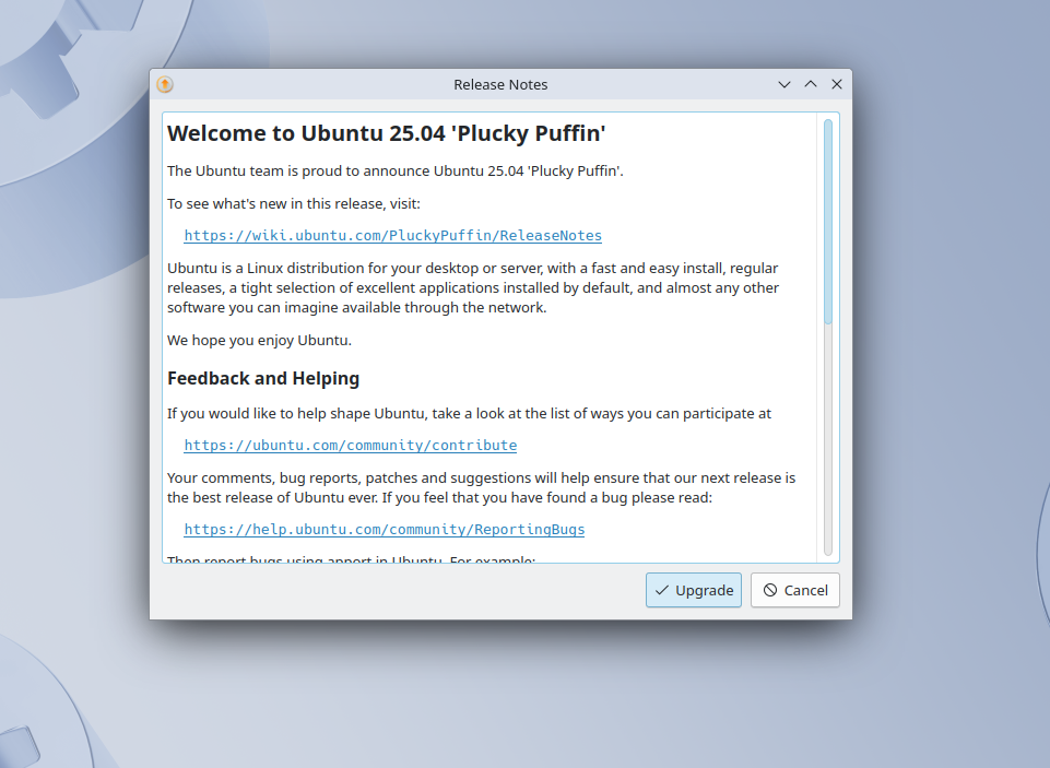

                          However, it sure seems to be working as it is *supposed * to for me, upgrading to 25.04 which is still till open for business.
                          I thought that 25.04 had past EOL, because I apparently can't add or read a calendar!
                          Click image for larger version  Name:	Screenshot_20251104_044344.png Views:	0 Size:	240.2 KB ID:	689134
                          Now, it hasn't gone any further than this, so it seems to have crashed.
                          No, it finally put up the empty box.
                          The command to start it manually is working.
