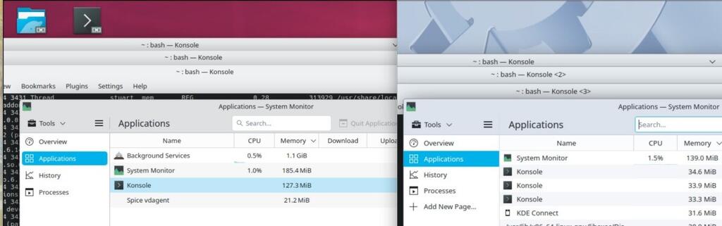

    On the 24.04 install, each new Konsole instance has a different window title: "~: - Konsole", "~: - Konsole <2>", etc. However, on the 25.04 install I see this: "~: - Konsole", "~: - Konsole", etc. ' Additionally, if one opens System Monitor on 24.04 you see multiple instances of Konsole but on 25.04 you see only a single instance.
    So it appears Konsole now runs as a single instance with multiple windows. Whether this is a bug or a change in code (this behavior likely saves RAM) could only be answered by the developer(s). I don't really use Konsole much so I have no ideas how to "fix" it. I prefer Yakuake. Maybe if you attempt correspondence with the devs or report it as a bug, you would at least get an answer.
      Here's the two VMs side-by-side with 25.04 on the left:

        Good sleuthing oshunluvr. I don't see how the 25.04 saves on RAM considering the sum of memory of multiple Konsoles in 24.04 versus the sum of the single Konsole process in 25.04.
