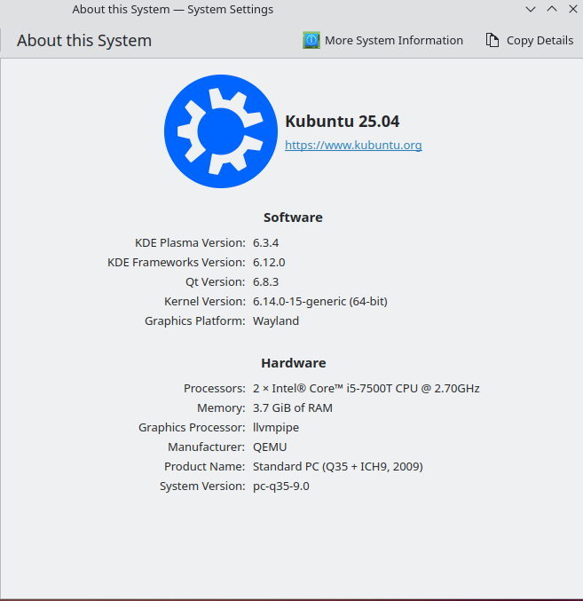

    You either installed Kubuntu's Plasma packages on top of an existing Ubuntu install, or you installed something Ubuntu on your Kubuntu. Or it is a small bug. The info is just pulled form a text file.
    Kubuntu is a respin of Ubuntu, so this happening is purely cosmetic. The "12"
    part I have no idea, that makes no sense
      part I have no idea, that makes no sense​
      I did no such thing, Kubuntu as been installed via USB on a formated disk. Any way to reset the "about system" section ?
        Maybe:
        https://www.kubuntuforums.net/forum/...lays-ubuntu-12
        Another possibility is you have something missing somehow. Especially if you actually have the Debian logo as seen above.
          This helped. Thanks a lot.
