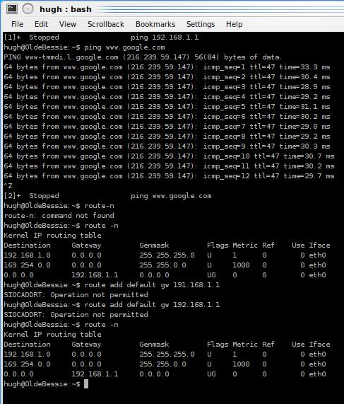

          Hello Oshunluvr
          Both Pings are successful
          Route -n yeilds a different result to your snapshot
          The route add is not permitted
          hmmmmm !

                Re: Konqueror - Cannot connect to the net
                try the route command with "sudo" in front of it.
                Assuming that it works - you will likely have to manually configure the route.
                It's not a big deal - I usually prefer to do it manually because I use port aggregation and network manager can't do that.
                Look at the contents of /etc/resolv.conf and tell us what it says.
