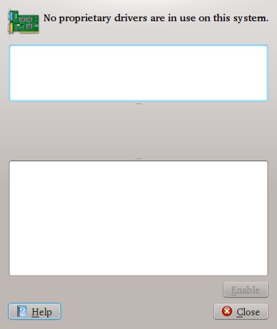

                Presumably, by "KMenu --> System --> Hardware drivers", you mean "KMenu --> System Settings --> Advanced --> Hardware"? If so I can't find any evidence of it scanning anything or any option for downloading drivers.
                  Nope. I'm running Kubuntu 10.4 with KDE 4.5.1 with the CLASSIC menu configuation, and my "Hardware" menu option is where I reported it. When you run it a dialog appears saying it is scanning... Then a window appears. I've attached a graphic of mine, which shows no unconfigured proprietary hardware.
