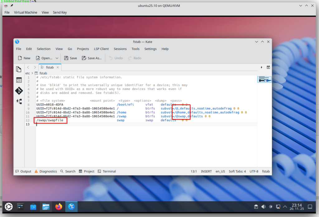

                              Ubuntu and Kubuntu do it a bit different I think. Find out if your swapfile is at /@swap/swapfile or /swap/swapfile or deleted. Start with:
                              swapon --show
                              ​If no output then swapfile is already deleted. In a new Kubuntu 25.10 the file is located in /swap/swapfile
                              Check your fstab text file if it is the same there.
                              Click image for larger version  Name:	Screenshot_20251120_233554.png Views:	0 Size:	451.9 KB ID:	689402
                              Turn off swap if it is still there:
                              sudo swapoff /swap/swapfile
                              ​Remove the file.
                              sudo rm /swap/swapfile
                              To create a new swapfile located in folder /swap/ that is mounted from the btrfs subvolume @swap for kubuntu:
                              sudo fallocate -l 16G /swap/swapfile
                              sudo chattr +C /swap/swapfile
                              sudo chmod 600 /swap/swapfile
                              sudo mkswap /swap/swapfile
                              sudo swapon /swap/swapfile
                              chattr +C is recommended to use on swapfile in btrfs filesystems.
