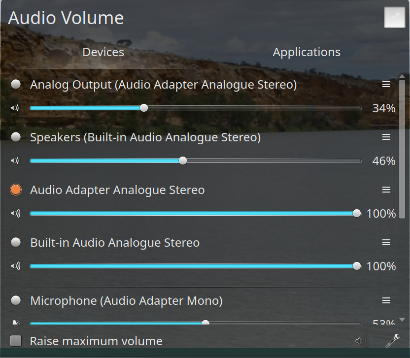

    I tried the pactl command you preferred and found that it gave 8 sound options for my system. They did not fit into the window for audio as shown below.

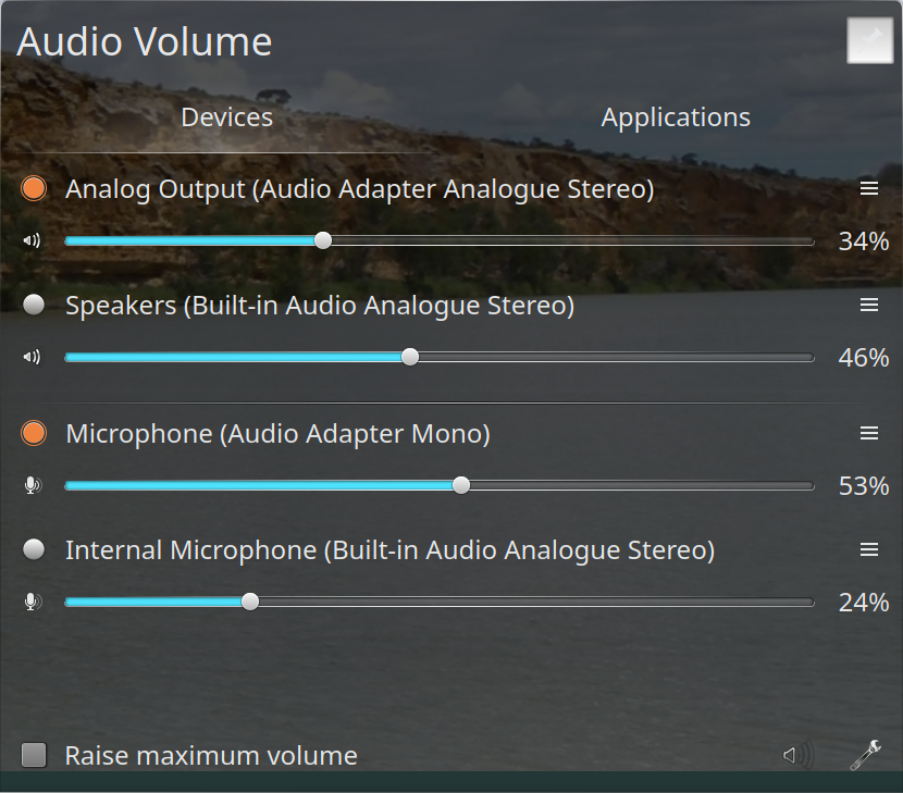

    Alternately, the above kill option, which I use and I believe is more appropriate for the current state of PulseAudio, gives the following on my system.
    Basically there is no duplication of sound devices such as "Built-in Audio Analogue Stereo" when using the pactl command.
    So for those sticking with Groovy, they have two options to fix the sound.

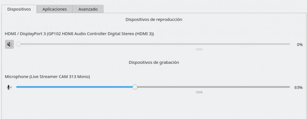

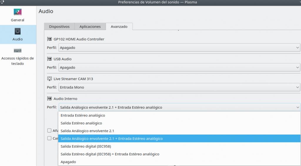

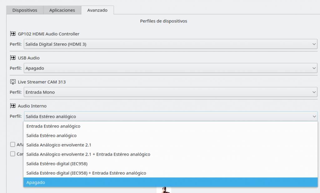

                            When you start the system, there is no sound. "Gorilla" detects HDMI audio from the graphics card, and also detects surround sound but does not detect the microphone. It also detects the webcam, audio and video. Nothing sounds.
                            So, I type:
                            sudo alsa force-reload
                            pulseaudio --start
                            And I get it to sound, but the configuration is not as it should be.
                            With version 20.04 it worked perfectly.
                              [ATTACH=CONFIG]9093[/ATTACH]
                              [ATTACH=CONFIG]9094[/ATTACH]
