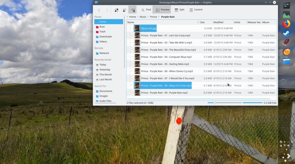

      this works @hear , However ,,,,,,
      1-I do not have an NTFS partition to test on
      2-it's working on a system running on a EXT4 partition and reading the Music folder from a BTRFS partition
      3-it was NOT working until I turned ON file indexing for the BTRFS mount , (I had it excluded)
      4- it only shows the info on the files themselves not the directory's
      hope this helps some

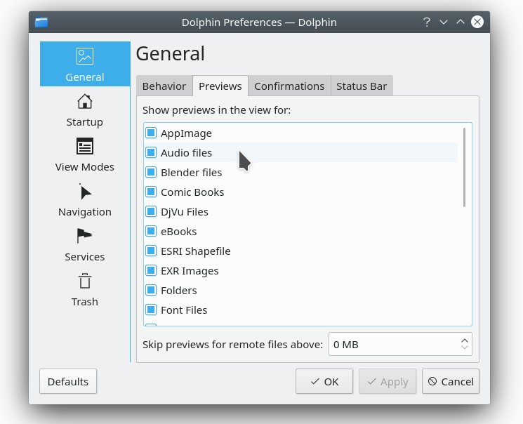

        Make sure you have previews turned on for audio files. If your audio file has an embedded pic it show show if you have the preview option selected.
        Can't say if this works on ntfs.
          It does.

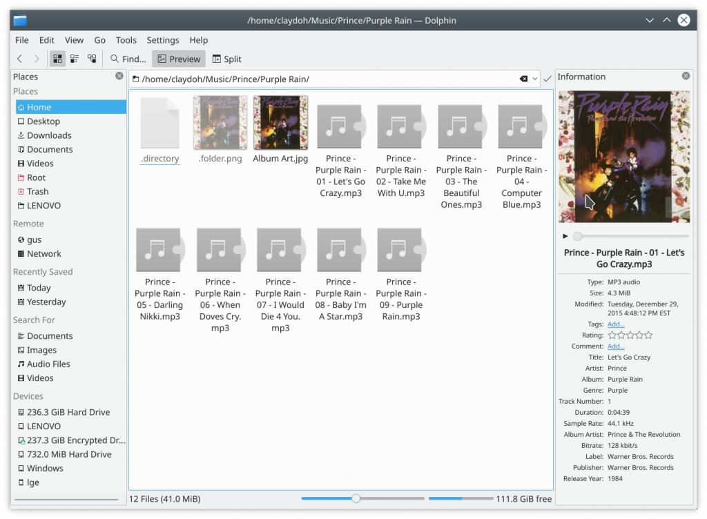

              A tad confused here (I blame advancing years) re Dolphin set-up.
              Have been using Strawberry snap prog for mp3s but Dolphin would be all I need.
              Downloaded singles tracks show as per Claydoh's pic.
              However albums - (cds K3b converted to mp3) - show ok in Strawberry but not in Dolphin. What is addling my brain is that in Dolphin each entry is named Artist - Track Number - Title.mp3 (ie capital first letter to each word with hyphen separation). However the Info panel shows artist/title words all underscore linked and some variation between capital/small case first letters!!
              Am I missing a setting in Dolphin or something more basic!
              Using Neon fully up to date

                Have you done this in Dolphin > Control > Configure Dolphin ?
                  All set as above except ESRI Shapefile?
