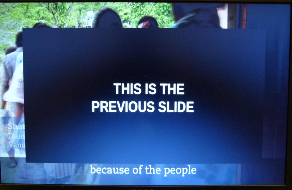

              I found that when I used the launchpad site https://launchpad.net/bugs/1820062 for this bug report, I found that it did not match the gtk3 problems reported there. So I have opened a new bug report on launchpad and this is at https://bugs.launchpad.net/launchpad/+bug/1821849.
              At this stage Launchpad has neither confirmed or assigned this bug. So if you have encountered this problem with embedded videos in LibreOffice Impress version 6.2.2.2, ie
              I would appreciate extra acknowledgement on this bug site.
              I am now happy that this Bug has been Confirmed as it effects multiple users. Hopefully it won't be too long before someone is assigned to solving the problems cited in this bug report.
              Last edited by NoWorries; Mar 27, 2019, 11:27 PM. Reason: Received notification that this Bug is now Confirmed

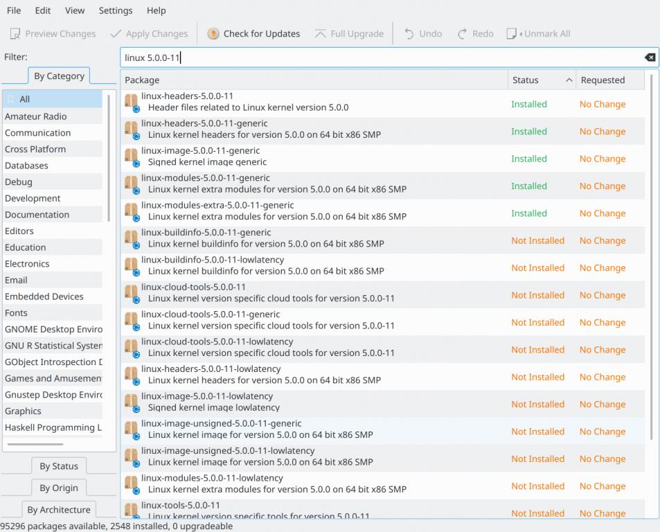

                            Originally posted by Flavio R. Cavalcanti View Post
                            I was not sure the problem was caused by Kernel 5.0.0.11 ─ so, did you confirm?
                            I have been using the Kernel 5.0.0-11 for some days now and have not had any trouble with it.
                            Muon packages that I have are:
Name:	Muon Linux 5.0.0-11.jpg
                              #44

                                Just to note another message (since January, at least) when installing new / removing old Kernels:
                                The link /vmlinuz is a damaged link
                                Removing symbolic link vmlinuz
                                you may need to re-run your boot loader[grub]
                                The link /initrd.img is a damaged link
                                Removing symbolic link initrd.img
                                But it didn't cause any problem, until last weekend. So, I don't know if it is a real problem.
                                Also, I have installed lm_sensors since November 2018, but had never runned sensors-detect, until last Sunday ─ after Boot problem.
                                It usually introduces 2 modules ─ and one of them is not found in all distros ─ so I had to edit /etc/modules to disable one of them:
                                [#]# Generated by sensors-detect on Sun Apr 14 14:03:36 2019
                                # Chip drivers
                                coretemp
                                # w83627ehf[/#]
                                But, these last things were done after the problem, and cannot explain its origin.
                                So, there are many variables to consider, and I am not able to try to understand what happened.
                                What matters is that there is no more any problem to boot with Kernel 5.0.0.11.
