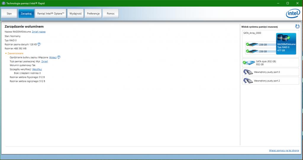

    2. It has an Intel CM246 chipset and M.2 SSD Combo (NVMe PCIe Gen3/SATA) with two Samsung SSD drives PM961 MZVLW256HEHP combined together into a firmware RAID 0 array – specification on the screen below

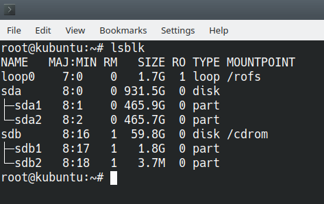

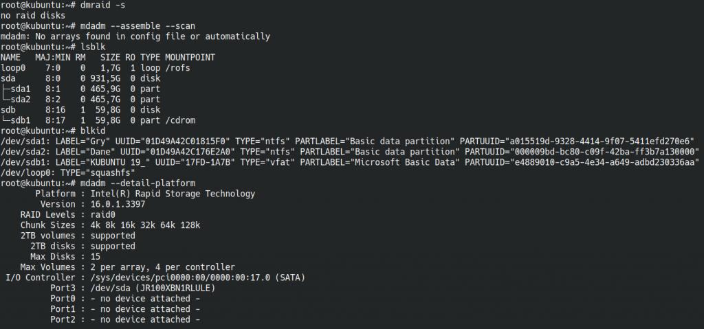

    I did some reading on RAID volumes under Linux, I tried to get a little bit inside Intel Rapid Storage Technology (Intel RST) in Linux document, and mdadm manual, but obviously I lack the know-how. Kubuntu doesn't detect the array, it even doesn't detect the SSD drives which are its components – lsblk command does not reveal them (in the picture: sda is my 1TB HDD, and sdb is an USB flash drive from which I run Kubuntu Live),

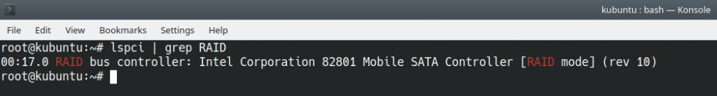

    but lspci | grep RAID shows that my system has RAID configured.

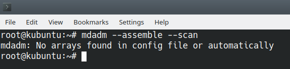

    But mdadm seems not aware of my array...

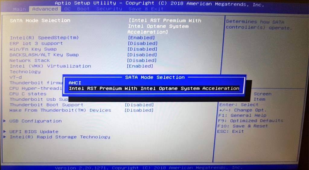

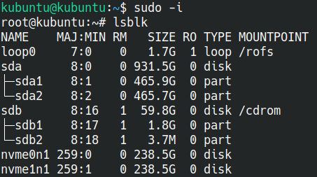

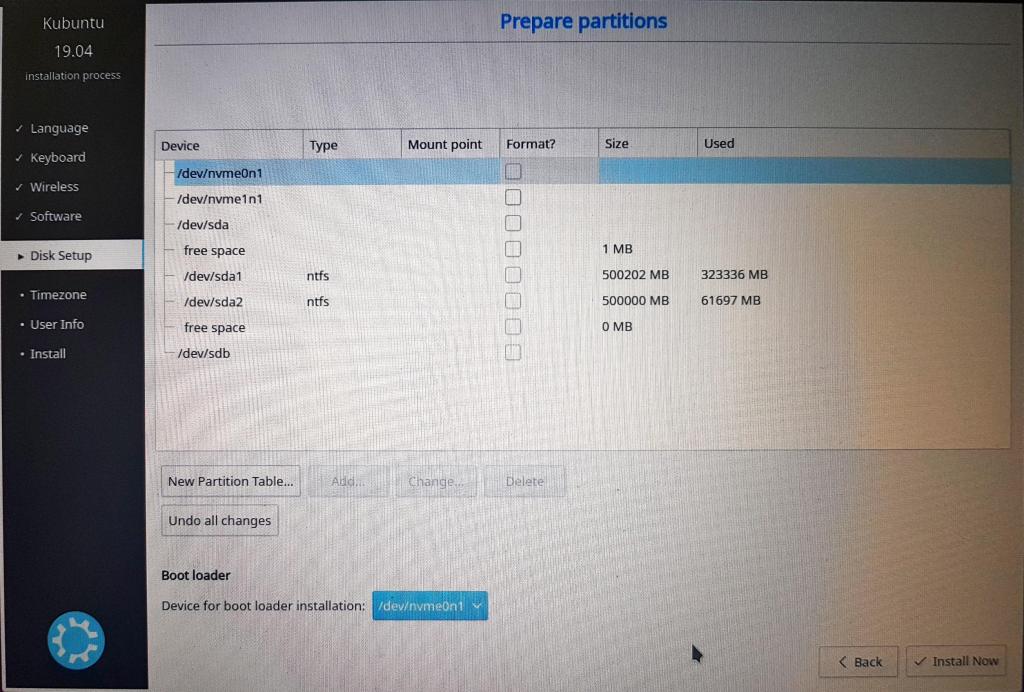

            Well, one advice seems to be repeating on many places - change setting in SATA Mode from RAID/RST to AHCI. It's not something I was looking for, but did that just to test if Kubuntu installer sees my SSD drives
Name:	2019_04_25 09_05 Office Lens.jpg
            and now
Name:	2019_04_25 09_22 Office Lens.jpg
            But still "mdadm --assemble --scan" does nothing - this time it retrieves no information.
            Anyway, it's not the way I want it to be, as I will most surely lose my Windows 10 installation and of course no RST.

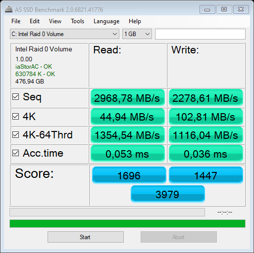

                        Well, unfortunately I wasn't able to make Kubuntu (or other distro) see my Intel RST RAID 0 array, so I dismantled it. In case someone has any doubts that RST gives some extra performance (I've read posts nearly saying that it is only pure evil), heres the comparison:
                        1. SSD test on Intel RST RAID 0 (fake RAID) on Windows 10
Name:	as-ssd-bench Intel Raid 0 Vol 29.05.2019 00-24-58.png
