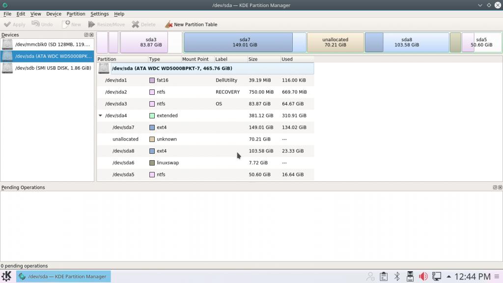

    Dear All,
    I was installing Virtualbox in Kubuntu 18.04 as the screen wrote me that there was a problem due to the lack of space. Therefore I used my USB drive in order to increase the size of Kubuntu 18.04 which is sda7. But it isn't possible!
    Find enclosed the partition:
    and my order:
    The error result is:
    Grow partition ‘/dev/sda7’ from 149.01 GiB to 219.22 GiB
    Job: Check file system on partition ‘/dev/sda7’
    Command: e2fsck -f -y -v /dev/sda7
    Check file system on partition ‘/dev/sda7’: Error
    Checking partition ‘/dev/sda7’ before resize/move failed.
    Grow partition ‘/dev/sda7’ from 149.01 GiB to 219.22 GiB: Error
    Please, does someone know what I should do?

    I suspect it's because your partitions are out of order. Thus the free space may not be along side sda7. I no longer have any MSDOS partitioned disks on my system, but "sfdisk -r /dev/sda" will fix the partition order. NOTE THAT YOU A MUCKING ABOUT WITH YOUR PARTITION TABLE! One false move can obliterate your data. Make backups - NOW - and make a backup of your partition table too, then proceed.
      Just curious about how those partitions are arranged. You might get some more insight by running
      sudo fdisk -lu
      against that hard drive, to see the start and end of each partition.
      (I am more familiar with GParted Live CD/USB than the KDE partition manager. You can also install gparted from Muon to your hard drive.) In your second graphic, "my order:", the re-size is for 219.22 GiB; why is the "size" in the drop down saying 224,478 MiB (= 224.478 GiB)? Just curious, what if you set the re-size target to, say, 215 GiB? And, yeah, you do want back-ups, of course. If you mess things up, usually TestDisk can put your partition table back together, but that's another sometimes stressful story.
        ... 219.22 GiB; why is the "size" in the drop down saying 224,478 MiB (= 224.478 GiB)?
        Nope, you're forgetting the 1024; that's what the "i" indicates. 1 GiB = 1024 MiB, so 224,478 MiB = 219.22 GiB (rounded to two decimals).
          Actually, this may be as simple as running fsck on sda7

                      Festplatte /dev/sda: 465,8 GiB, 500107862016 Bytes, 976773168 Sektoren
                      Einheiten: Sektoren von 1 * 512 = 512 Bytes
                      Sektorgröße (logisch/physikalisch): 512 Bytes / 4096 Bytes
                      E/A-Größe (minimal/optimal): 4096 Bytes / 4096 Bytes
                      Festplattenbezeichnungstyp: dos
                      Festplattenbezeichner: 0x9a91e749
                      Gerät Boot Anfang Ende Sektoren Größe Kn Typ
                      /dev/sda1 63 80324 80262 39,2M de Dell Dienstprogramm
                      /dev/sda2 * 81920 1617919 1536000 750M 7 HPFS/NTFS/exFAT
                      /dev/sda3 1617920 177500584 175882665 83,9G 7 HPFS/NTFS/exFAT
                      /dev/sda4 177502206 976766975 799264770 381,1G f W95 Erw. (LBA)
                      /dev/sda5 870658803 976766975 106108173 50,6G 7 HPFS/NTFS/exFAT
                      /dev/sda6 854465283 870658739 16193457 7,7G 82 Linux Swap / Solaris
                      /dev/sda7 177502208 490000383 312498176 149G 83 Linux
                      /dev/sda8 637235200 854462463 217227264 103,6G 83 Linux
                      Partition 1 beginnt nicht an einer physikalischen Sektorgrenze.
                      Partition 4 beginnt nicht an einer physikalischen Sektorgrenze.
                      Partition 5 beginnt nicht an einer physikalischen Sektorgrenze.
                      Partition 6 beginnt nicht an einer physikalischen Sektorgrenze.
                      Partitionstabelleneinträge sind nicht in Festplatten-Reihenfolge.
                      auie@Latitude-E5530:~$ [/#]

                        If I read correctly the error you got, it seems there is a problem with sda7.
                        Looking at the following tells that you should be able to expand sda7:
                        /dev/sda4 [B]177502206[/B] 976766975 799264770 381,1G f W95 Erw. (LBA) [B][COLOR=#ff0000]<-- Extended partition[/COLOR][/B]
                        /dev/sda7 [B]177502208 490000383[/B] 312498176 149G 83 Linux
