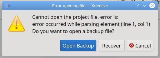

            When I try to open the file I get...
                [ATTACH=CONFIG]9217[/ATTACH]

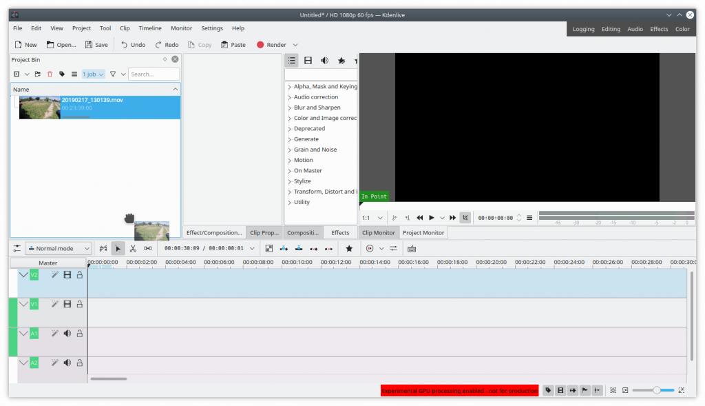

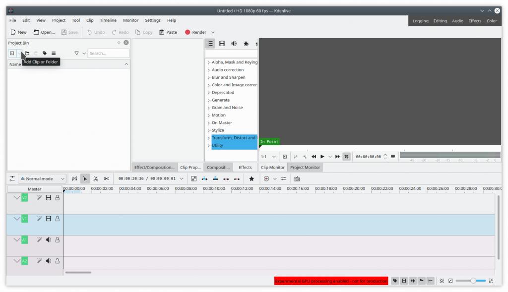

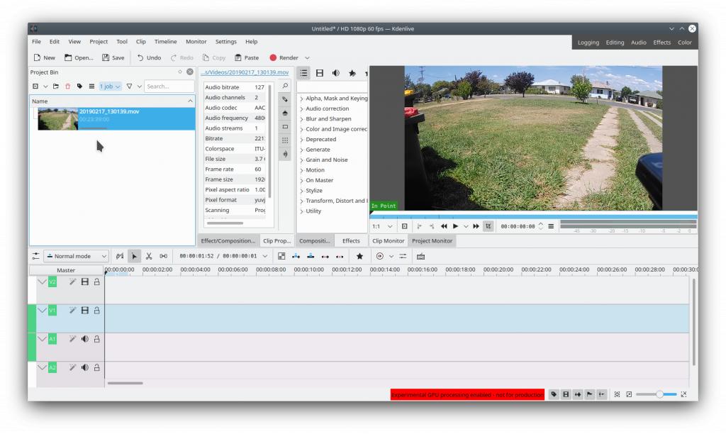

                Well, yes, an MTS video file is not a kdenlive project file. In most video editors, you have a project that you add clips to. Clips being video files. The project file holds all the info about edits, transitions, etc.,to be performed and is not a video file itself.
                Once you open the editor, you have to add clips to it.

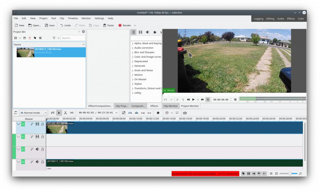

                Then you drag a clip to the timeline

                Openshot, and most if not all video editors on Linux work in the same manner.
