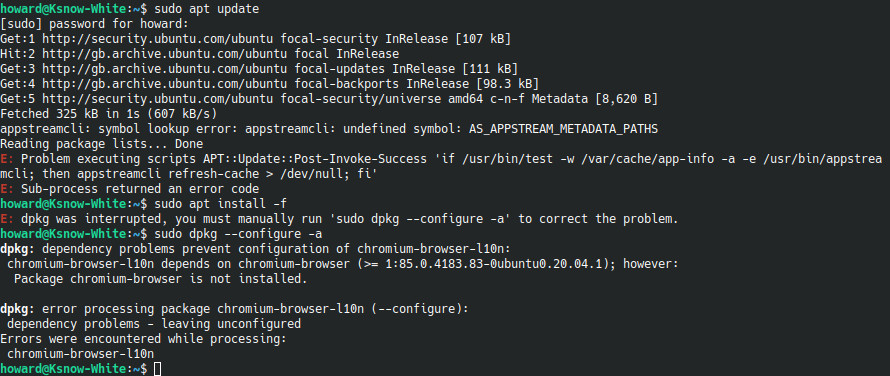

    After the upgrade routine finshed, the update info showed that I still had 902 files to update. I ran sudo apt update

          No joy. I get a variety of error messages. I am posting the latest. Some of these refer to Chromium. I have the Chromium browser but I have not been able to uninstall it.
Name:	Chromium error.jpg
ID:	644890Click image for larger version

            I ran sudo apt full-upgrade and pressed Enter when the Chromium snap thing came up.
            20.04 installed without a hitch! I've been using it for several hours now, and did a couple of re-starts. All good!
