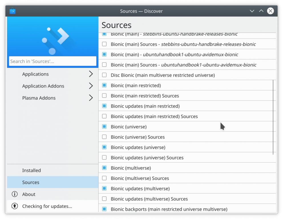

                    Actually, my sources are quite straightforward. Each 'bionic' entry for the normal repos is followed by which component it is for -- Main, Universe, Updates, Multiverse, Backports
                    However, the Neon entry at the bottom, and not shown in my well-planned screenshott, doesn't/can't indicate what it is, as it is just another standard source as far as apt is concerned.

                      I counted 10 entries that say only "Bionic (main)" with no further info. BUT if you click on it, it displays a single line showing the source name. Of course, a dumb side panel opens taking half the screen and there's a cute back ground of a latte under the area where the text is displayed just to make it harder to read. What The Frank? Who in the world thought that was a good idea? Some friggin' hipster no doubt. Add what exactly does a latte have to do with Linux or Plasma? You can sum it up as using a lot of screen space for almost no information. Next thing you know the Help function will be a link to some stupid Youtube video.

                          I just discovered (pun) that my Discover looks different than on another PC.
                          It's seems my main desktop PC has Discover version 5.12.8 and my new work computer install has 5.15.4. This is why I'm not seeing the sources descriptions I think. On the new work PC I see an italicized label in the description and on my older desktop I do not.
