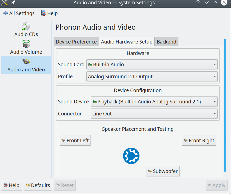

            Alright! Thank you for responding. oshunluvr - Audio Hardware Setup:

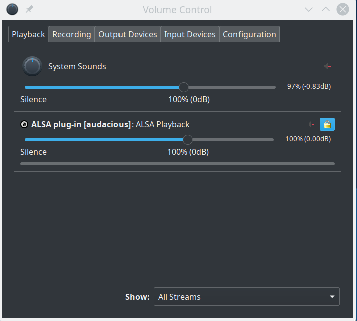

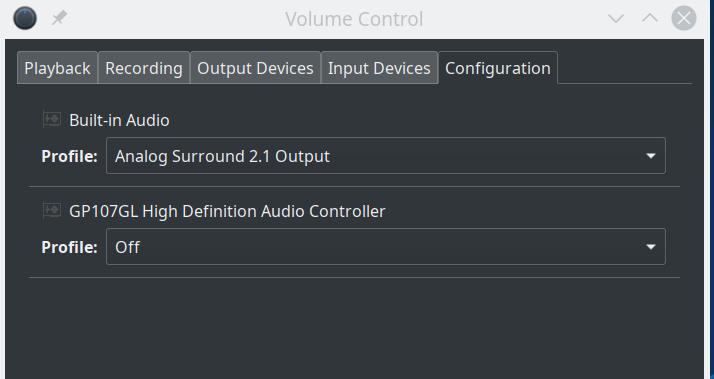

            Here are all the Pulse Audio Volume Control tabs:
Name:	PAVControl- Playback.png
