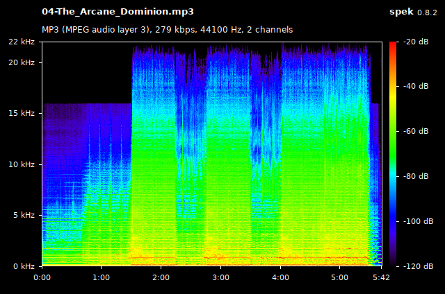

    There are 2 problems here, inter-related. I just got a new USB cdrom drive, as the built-in drive is starting to go sour. I normally do cd ripping with ripperX, as it is the only ripping program I have found that actually does what I tell it to do, particularly regarding mp3 quality. But it won't see the cdrom drive. The drive is there, it is mounting as /dev/sr1, but ripperX seems only to see sr0. So first question, anyone know how to get it to see sr1? There are no config options for this, and noting in its .ripperXrc file.

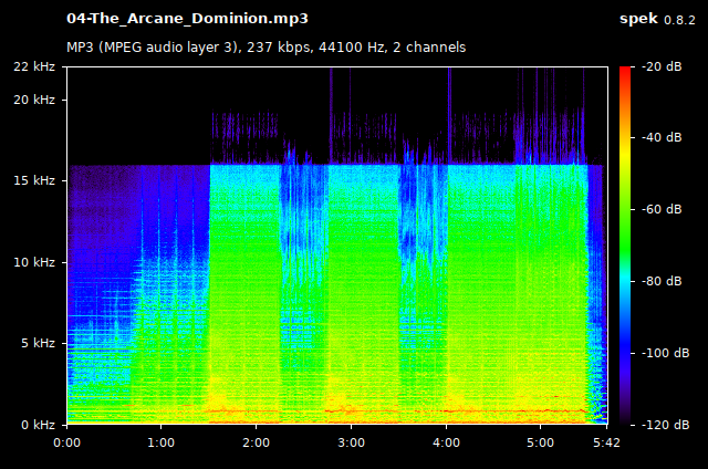

    Second related problem: K3B does see the drive, but in spite of what I tell it, its ripping quality is garbage.
    Pictures worth more than words:
    RipperX quality:

    K3B quality:
    Yecch.
    Anyone know if it's possible, somewhere, to force k3B to use my parameters instead of its own?

      but even with everything set to max, it still isn't giving the same quality. No way to specify the actual parameters it sends to LAME.

          Come to think of it, MP3 saves bits by removing sounds you are supposedly less likely to hear. I recall reading somewhere that one example of this is that if you have two tones, one at X dB and one at less than X-29 dB, you supposedly can't hear the softer tone.
          It appears you have high frequencies at -80dB and lower frequencies around -50dB, and the transcoder is deciding to cut the high frequencies because "you can't hear them anyway." Can you hear the difference?
          (Which doesn't mean that you shouldn't have the option to have higher quality settings, just that that's probably the default setting for K3b.)
            I don't know that much about the tech details of mp3 encoding; it IS lossy, and the difference between even good mp3 and FLAC is quite noticeable. In the example in my original post, with cheap earbuds or some other such abomination, no difference, but with good headphones the difference is obvious (at least to me). You're right, the best way to do this is rip to FLAC or WAV and then manually encode it, and I may eventually go back through all my stuff and do it that way.

                Clearly K3b uses a lower quality setting. The bitrate of 237k seems odd -- is it using VBR?
