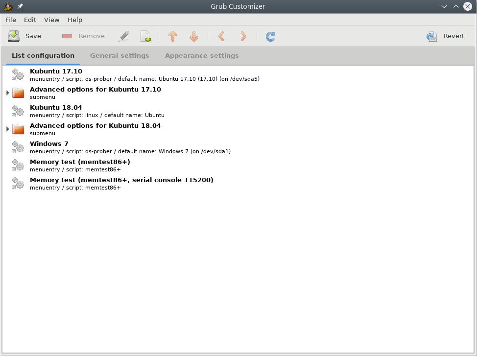

    Because the installation of Bionic puts it at the top of the Grub startup menu, which I didn't want, I decided to install grub customizer. This allows me to change the startup menu order. It is installed by:
    sudo add-apt-repository ppa:danielrichter2007/grub-customizer
    sudo apt-get update
    sudo apt-get install grub-customizer

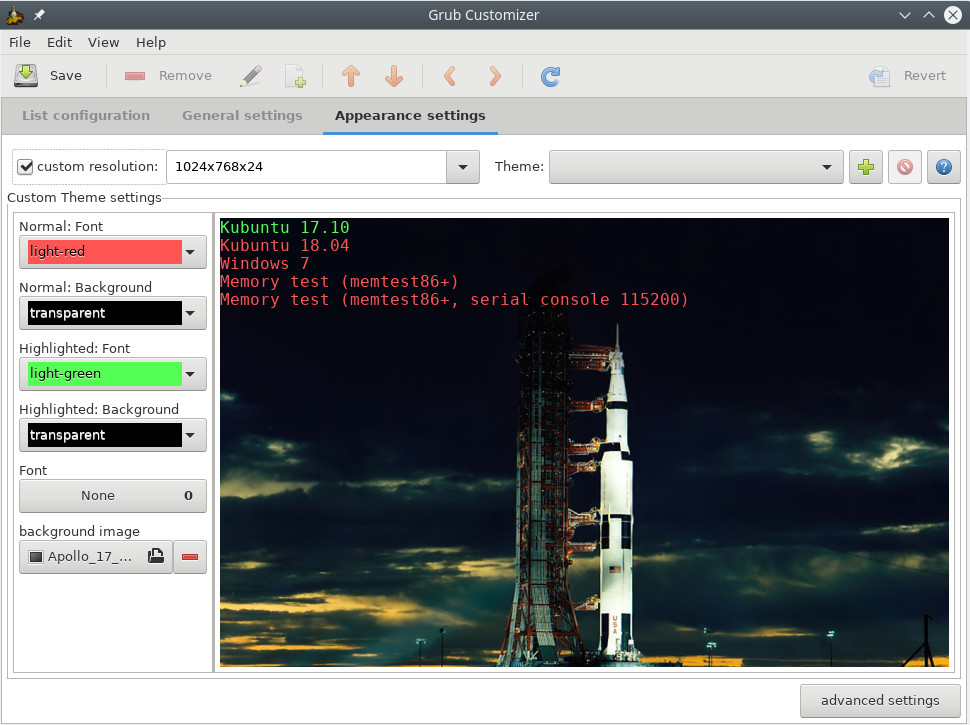

    With this package I changed the order of the Grub options and the menu names from Ubuntu to Kubuntu. I also added a background graphic. This step took me much longer that I care to mention. The reason for the problem related to that fact I had a jpg image which worked but when I tried other jpg images with different options they all failed. The penny finally dropped when I changed to a png format and I could use the highest resolution image that I could get.
    The image that I chose was from a search of Google Images with "Apollo 17 night launch". Apollo 17 was the last moon launch. This image provides a black background where the Grub text needs to be. I also find it symbolic of launching Kubuntu and while not the last it is the latest.
    To get this image as background, I found guidance from the ubuntu help site: https://askubuntu.com/questions/5406...een-resolution
    I used Gimp to crop the image to the chosen size and saved it as a "png" file. I NO LONGER USE JPG WITH GRUB.
    The grub-customizer windows are shown below to illustrate what I did.

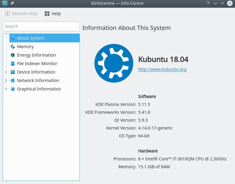

    My system info at this time is now.
    I must say that I am enjoying being able to appreciate all the excellent progress being made by the developers behind Bionic. Considering it is one week before Alpha 2, this is an incredibly stable system at this early stage and it has always worked for all I want to do. I am impressed!!!!

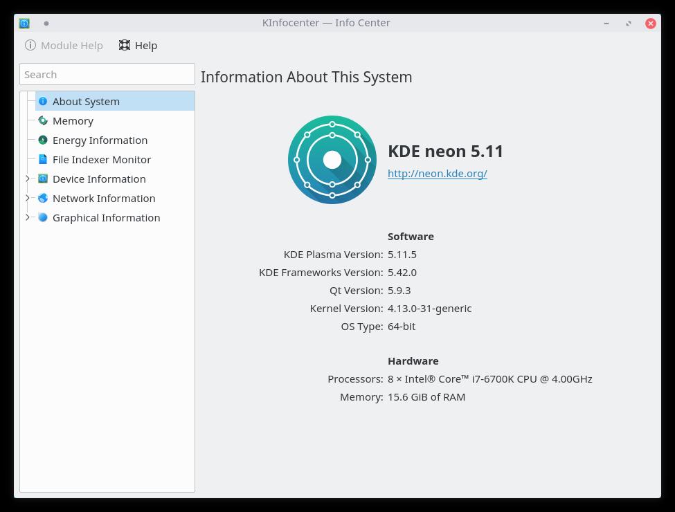

          Looks like all the Neon Lovers have invaded this post. So sorry that you are in love with Neon as I am in love with Bionic.
          I should point out that while you are ahead by one with KDE Frameworks Version, I am ahead by one in the Linux Version QED.
