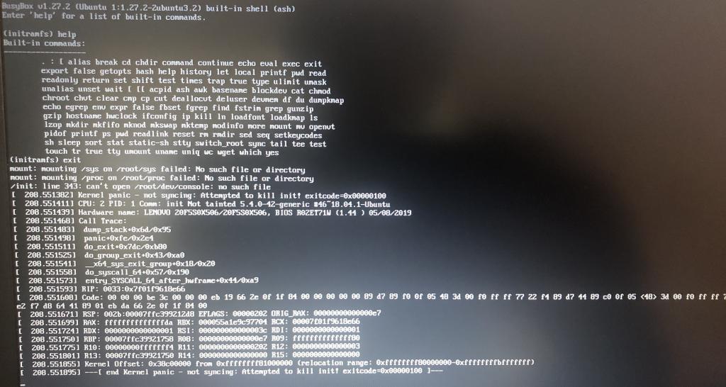

    After downloading yesterday's updates and rebooting, my file system seems to have been corrupted. My Thinkpad X260 booted to 'initramfs'.
    I found several similar solutions but none seem to exactly match my conditions and I don't want to fry my system.
    I typed 'help' to get a list of commands. and 'exit' which pulled down which directories are corrupted. Some seem to be entirely missing, as opposed to simply scrambled.
    What can I do to fix it?
    Here is a screenshot
    Can you boot from the previous kernel successfully?
      Yes. Using Refind, I was able to go into Grub and choose a previous kernel and boot into that.

            I was able to uninstall the bad kernel using Muon. Reboot into the previous kernel happened automatically with the next reboot.
            So should I try to re-install 5.4.0-42 or should I just walk away? I'm a little afraid it will break my system again...
              It is highly likely something broke during the installation of kernel 5.4.
              You never "broke" your system since you managed to fix it yourself.

                I've been seeing this on my KDEneon install fairly often. In my case I'm suspicious that it's hardware related, but I don't know which piece of hardware, but it might be 18.04.
                Mine happens this way:
                • Using the computer heavily - like gaming or transcoding.
                • Computer locks up.
                • Sometimes it reboots itself, sometimes not.
                • After reboot or repowering, it almost always shows similar kernel panic.
                • Sometimes 2-3 resets results in a good boot.
                • More often, I select the previous kernel and it boots.
                • In either case, I rebuild the initramfs for the newer kernel and next reboot, it's fine.
                Since it seems to always happen during heavy load, it could be RAM or heat.
                The point of sharing this is twofold: it may not actually be the kernel, and it is usually fixable by just rebuild initramfs.
