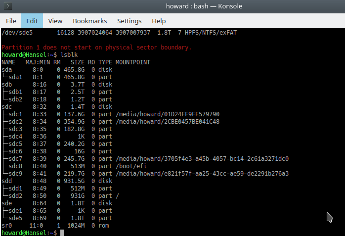

                The post #3 method did not work either. Ubuntu is still at position #7.
                I have 4 hard drives and 1 SSD! The Kubuntu install is on its own drive, dev/sdd, I will run the command again and post here later.
                  The message is clear but how to fix it?

                        howard@Hansel:~$ sudo fdisk -lu
                        [sudo] password for howard:
                        Disk /dev/sda: 465.8 GiB, 500106780160 bytes, 976771055 sectors
                        Sector size (logical/physical): 512 bytes / 512 bytes
                        I/O size (minimum/optimal): 512 bytes / 512 bytes
                        Disklabel type: dos
                        Disk identifier: 0x83269276
                        Device Boot Start End Sectors Size Id Type
                        /dev/sda1 * 2048 976769023 976766976 465.8G 7 HPFS/NTFS/exFAT
                        Disk /dev/sdb: 3.7 TiB, 4000787030016 bytes, 7814037168 sectors
                        Sector size (logical/physical): 512 bytes / 4096 bytes
                        I/O size (minimum/optimal): 4096 bytes / 4096 bytes
                        Disklabel type: gpt
                        Disk identifier: 2B83813A-9927-45C7-86D2-9A4B65D3E8C6
                        Device Start End Sectors Size Type
                        /dev/sdb1 2048 5251035135 5251033088 2.5T Linux filesystem
                        /dev/sdb2 5251035136 7814035455 2563000320 1.2T Linux filesystem
                        Disk /dev/sdc: 1.4 TiB, 1500300828160 bytes, 2930275055 sectors
                        Disklabel type: dos
                        Disk identifier: 0xd0e3f806
                        /dev/sdc1 16134 288559529 288543396 137.6G 7 HPFS/NTFS/exFAT
                        /dev/sdc2 288575592 1032867044 744291453 354.9G 7 HPFS/NTFS/exFAT
                        /dev/sdc3 1032867048 1416164851 383297804 182.8G 7 HPFS/NTFS/exFAT
                        /dev/sdc4 1416165374 2930274303 1514108930 722G 5 Extended
                        /dev/sdc5 2393128960 2896863231 503734272 240.2G 83 Linux
                        /dev/sdc6 2896865280 2930274303 33409024 16G 82 Linux swap / Solaris
                        /dev/sdc7 1416165376 1931359827 515194452 245.7G 83 Linux
                        /dev/sdc8 * 1931360256 1932410879 1050624 513M ef EFI (FAT-12/16/32)
                        /dev/sdc9 1932412928 2393122815 460709888 219.7G 83 Linux
                        Partition table entries are not in disk order.
                        Disk /dev/sdd: 931.5 GiB, 1000204886016 bytes, 1953525168 sectors
                        Disklabel type: gpt
                        Disk identifier: 75A5DE07-F101-4146-BE44-F869B7EDBA5D
                        /dev/sdd1 2048 1050623 1048576 512M EFI System
                        /dev/sdd2 1050624 1953523711 1952473088 931G Linux filesystem
                        Disk /dev/sde: 1.8 TiB, 2000398934016 bytes, 3907029168 sectors
                        Disklabel type: dos
                        Disk identifier: 0x5a77faf0
                        /dev/sde1 16065 3907024064 3907008000 1.8T f W95 Ext'd (LBA)
                        /dev/sde5 16128 3907024064 3907007937 1.8T 7 HPFS/NTFS/exFAT
                        Partition 1 does not start on physical sector boundary.
                        howard@Hansel:~$

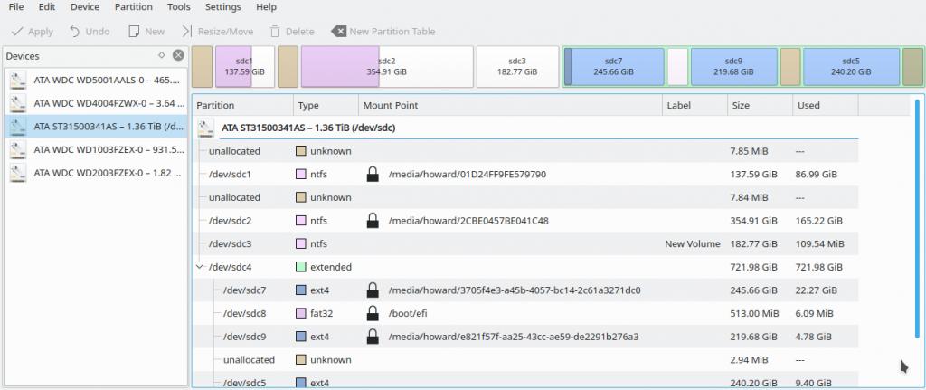

                        3.
                        From all this it seems to me that I have two Linux Mint installations, one which is the default (efi/boot - sdc8),
                        The Kubuntu install is definitely on dev/sdd.
                          Wow, what an interesting and complicated setup you have there, JoHubb. I'm amazed it works so well. There is nothing wrong with it, but it is a complex weave of things (boot-wise).
                          If that is true, then it is the GRUB from sdc8 from which you are seeing that GRUB boot menu when you boot up, right? So it is the one that needs to be edited as per Post #3. You can try it: boot into that Mint, and do the Post #3 edit to that configuration file ... -->
                          Btw, when you are in sdc8, look at the GRUB boot menu: /boot/grub/grub.cfg. It's quite technical, but look down through it and you'll come to lines starting with menuentry, like this:
                          menuentry 'Ubuntu' --class ubuntu --class gnu-linux --class gnu --class os $menuentry_id_option 'gnulinux-simple-c5f5de3a-2606-4923-a249-151052b877e0'
                          That one represents my Kubuntu (it is called Ubuntu, but it is actually my Kubuntu -- your Mint's may also be called Ubuntu's as they are Ubuntu derivatives).
                          So, anyway, study that file /boot/grub/grub.cfg from Mint on sdc8. Do those menuentry lines correspond to the boot menu that you see when you boot your PC? If so, that does (quite probably) confirm that it is sdc8 that controls your "booting show." Thus, editing it (as per Post #3) should do the trick, I think, I hope, if we are lucky ...

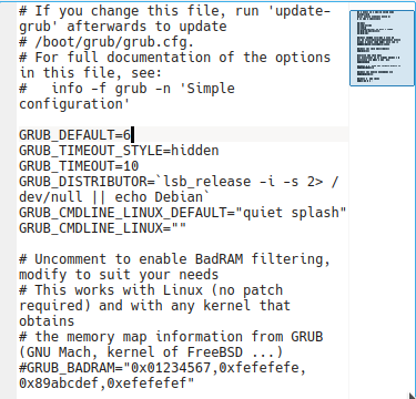

                            Hm...thanks, my computer runs perfectly in all the different OSes and distros! Amazing is right, given that I know so little about Linux.
                            I checked the /boot/grub/grub.cfg and there is a long list of 'menuentries' for Linux Mint, each maybe representing a different partition in dev/sdc. Both Windows 10 and Ubuntu appear near the end of the list.
                            When I tried to alter the /etc/default/grub.cfg in sdc8 (as per Post#3), the editor wouldn't overwrite. I tried the default text editor and Kate but neither would overwrite the file.
                            I guess since everything runs well, I am tempting fate by messing with the grub menu order. It is a small inconvenience to have to select Ubuntu pre-boot, but nothing more than that.
                            Maybe I should leave well enough alone?
                              The file grub.cfg has to be edited with root privileges. You were in Mint while you do that, and I don't know how Mint handles the root privileges for editing grub.cfg (or other system files) -- it could be something like a menu choice "edit as root" or "save as root." Do you know? This usually isn't a big deal -- it is just that in your case, you have so many things going on.
                              One could make a strong argument for that! At the same time, if you could do the Post 3 edit with the root privileges, it wouldn't hurt to try -- you could always change it back again. (HOWEVER, running anything like grub-install could get us into a mess.)
                              (Not too relevant, just curious: Is your PC like from 2011 to 2013?)
