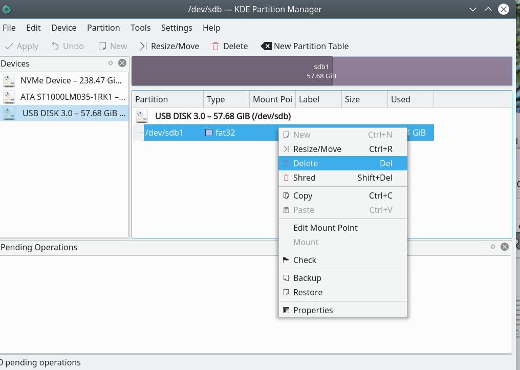

    There are a couple of ways to format the disk in Partition Manager (Gparted will be very similar)
    One way is to right click the partition, select properties, and there will be a box at the top to select the file system, change that to whatever you want. After you close the window, click "apply" at the top of the formatter.
    You can also wipe then format it by right-clicking on the partition, and selecting delete, then again right clicking and select "New", and only edit the filesystem option to (ext4, fat32 etc),selecting OK, then Apply.
