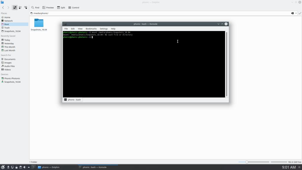

    Some advice to the btrfs USB being mounted properly.
    I did try manually without success
    Wierd
      Check the man page for mount. You've got the syntax totally wrong.
      It looks like you've already tried to mount something on /media. Were you successful using good syntax?

        Isuue Sorted
        ALL IS GOOD!
        After creating, one needs to mount their btrfs formatted usb before sending "in root" with
        mount /dev/disk/by-uuid/[HL][B][I]your_btrfs_formatted_usb-uuid[/I][/B][/HL] /mnt
        Then send @ "in root" with
        btrfs send /mnt/snapshots/@_basic_install | btrfs receive /media/[I]user-name[/I]/[I]the_btrfs_usb[/I]
