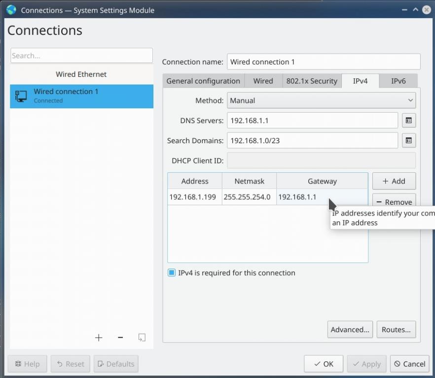

      or you can use the Network Manager like I did here on my desktop:
      My server has no GUI so I couldn't use NM for that.
      If you;re using a normal 255.255.255.0 netmask, replace the /23 with /24 in the above examples.
