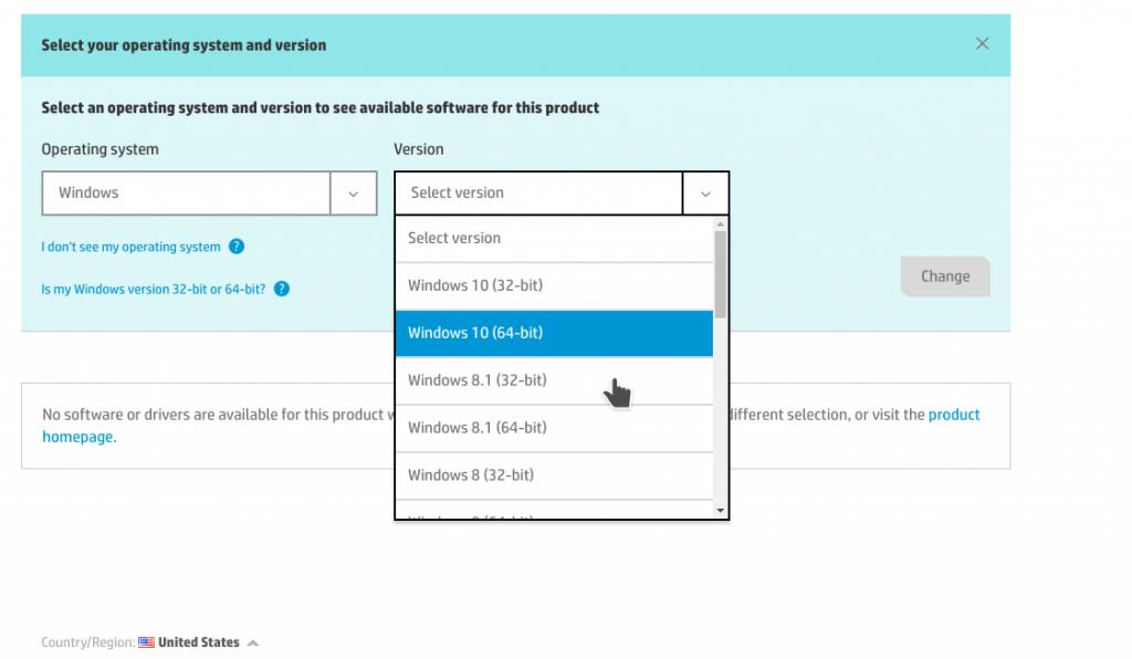

The next link you gave me does not have anything for WIN10.
