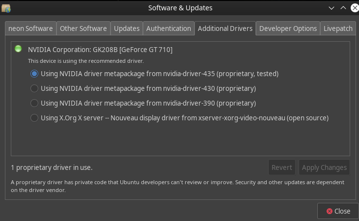

                You could try with software-properties-gtk (software-properties-kde does not seem to have an "additional drivers" section).

                  Maybe that years-old driver is too out of date for the new kernels, so the kernel is looking for a patch to make it work. Why not install a driver from this century? Nvidia's website doesn't even list the 390 series when search for that card. It suggests 430- or 440-, both of which are in the repos.
                    That is because the driver manager is in System Settings in Kubuntu, where it has always lived.
