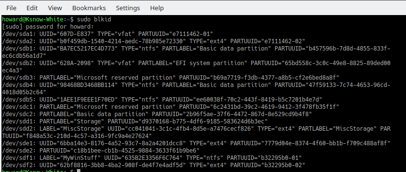

      Maybe I am underestimating the complexity of the cloning process.
      It seems from this that some partitions have their own UUIDs. Which UUID to use when I clone an entire disk?
      I've done this in Windows but maybe it isn't as straightforward in Linux.

        Well, if you clone them, the UUID should get cloned too.
        I was just mentioning that if you do get problems - they can occur - booting in text mode is the easiest way to spot them, and checking fstab for mismatches the... most likely way to fix them.

          Be clear about the difference between drives (aka "disks", even when they're not disks) and file systems, aka partitions. A drive can have several partitions, and typically does. Both drives and file systems have UUIDs.
          *buntus do not use the drive UUID for anything as far as I am aware. fdisk -l will show it as the "Disk identifier". But Windows might for its purposes, maybe for boot and licensing. fdisk in expert mode can set it, as can the windows "diskpart" utility, but I have no idea how advisable this would be; it's really a windows thing. When a new partition table is written to a disk, a new disk identifier is generated.
          blkid shows file system UUIDs. If you clone a whole disk all the partitions get cloned along with their UUIDs. If you clone a partition, its UUID is cloned. If you have a file system and its clone in a system when it boots it's bad, with both OS and user really confused. Like Don B. Cilly I've made that mistake. There's lots of ways to write a new UUID to a partition; I like using gparted.
          Crucially, by default grub uses UUIDs to find itself and the OS to boot. Linux by default mounts drives via /etc/fstab using the UUIDs. Use sudo update-grub to make grub aware of changes to UUIDs, and you can edit /etc/fstab if necessary.
          (I hate UUIDs, they've caused me pain over the years. Neither grub nor /etc/fstab need to use them, they can use labels, which are much easier for humans to use and remember. My Kubuntu uses labels, but I can because I manually maintain my grub configuration. Labels have the same pitfalls as UUIDs if you clone a drive or partition.)
