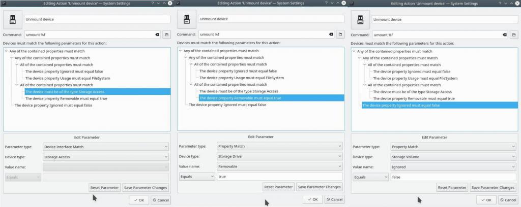

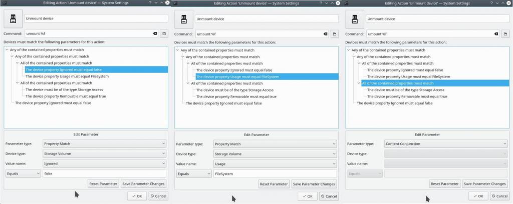

                  #2 The notifier actions. Hey, it turns out you can add any custom actions you want to the device notifier if you know the proper foo to make it work. I did it in about 10 minutes. It's not intuitive so I screenshot-ed the steps. First off - check this out!
                    To add this to Notifier, open Settings and navigate to Hardware > Removable Storage > Device Actions. At the bottom, click " + Add " and a window will open asking for Action Name. Enter "Unmount device" then another window opens. In the "Command:" entry, enter "umount %f". Now you must go the the window below and start entering the conditions for the action. Here, I used screenshots, so do these one at a time and verify you entered the info as shown. Click "Save Parameter Changes" as you work through each parameter and click "OK" when you're done. Once complete, you may have to log out and back in for the new option to appear.
                    Here we go:
                    one of three
                      two of three:
                        three of three:
