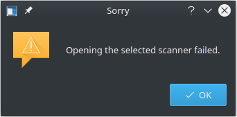

                  using skanlite it actually finds a device, but before it has a chance to display it in a way that i can see, it fails, and immediately replaces the device name with an alert box that says "Sorry - Opening the selected scanner failed." and gives me an OK button...
                  which isn't an awful lot of help, although it is somewhat more than it was detecting yesterday.

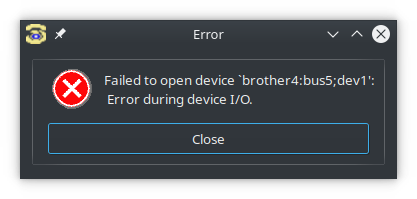

                  xSANE gives me a little more information: it says "Failed to open device `brother4:bus5;dev1': Error during device I/O." and a "Close" button.

                  no, it's not. i've got a USB-A to USB-B cable in the back, along with all the other cables.

                      The download page has a "scanner setting file', which os the udev rules to allow scanning as normal, non-sudo user, but does not list support for newer Ubuntu.
                      I am leaning toward the permissions issue, lets check a few things
                      list the output of the lsusb command, so we can compare what scanimage says vs lsusb about device info
                      Look at the file /etc/sane.d/dll.conf and see of there s a line present containing 'brother4'
                      install xsane, and try running xsane with sudo, to see if this works.

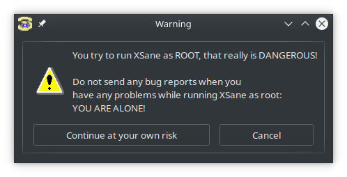

                        running xSANE as root gave me a REALLY SCARY message when i started it, saying
                        You try to run XSane as ROOT, that really is DANGEROUS! Do not send any bug reports when you have any problems while running XSane as root: YOU ARE ALONE!
                        but it appeared to work as expected...

                          As it worked with sudo that tells us it is a permission issue which should be a fairly easy fix. I'm not sure that the package Brother have for this will work on 18.04, but if not a simple edit of a file should.

                              You might try just adding your user to the "scanner" group and logging out and back in.
