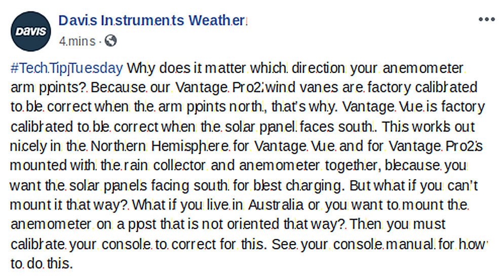

    On my new/old 18.04 computer (Optiplex 990) I get strange artifacts when I am typing specially on some web-pages like Facebook.
    I've taken a snapshot and blown it up a bit so it's easier to see.
    Most of the times it looks like little "J"s have been inserted in to words. In this case it is not something I have written but sometimes it is.
    Is this a hardware issue, display card etc or a software issue?
    Here's what it looks like...

                  If I look at your picture, it looks like almost every 'j' comes after a letter with a round 'belly' like o or b. And most points come are after a h. It looks like the description of the font tries to change the space between two combinations of letters, but instead of changing the space you see the commands. Or something like that.
                  As far as I know it's the font together with the browser that are responsible for that kind of commands.

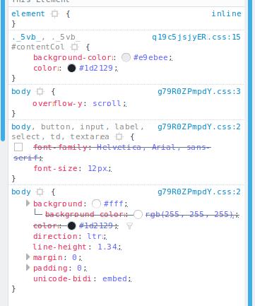

                      I followed your instructions and unchecking the box seems to have cured the issue.
                      Here's a photo of that listing.
                      Next I'll try to follow your instructions on reloading that font.

                        font-family: Helvetica, Arial, sans-serif is a very common combination, because (almost) every system has Arial or Helvetica installed.
                        On my Ubuntu 15.04 Arial is installed.
                        (The rule means: use Helvetica. If that's not installed: use Arial. If that's also not installed, use a font without serifs (little lines at the end of the letters). Maybe I write too detailed, but I don't know how much you know about this stuff.)
                        So Firefox is probably using one of your own fonts, probably Arial. In that case reloading the font has no effect, because the font is never downloaded, since it's already installed on your system.
                        I really don't understand how unchecking that mark can make a change, because you are probably still using the same font.
                        O no, wait. Maybe that's not the case any more.
                        First: are you sure you unchecked ALL lines starting with font or font-family? (On top of the right column of developer tools there's a little text field with 'Filter styles' in it (or something like that). If you type 'font' in there, you'll only see rules with font in it.)
                        Second: if I look in the settings of my Firefox, the default font is DejaVu Serif. If I uncheck all font-rules, that's the font that's used by my Firefox.
                        You could have a look at your Firefox-settings to see what's your standard font. (Settings first page under heading Fonts & colors, or something like that.)
                        Or as an alternative: if you have unchecked ALL rules with font / font-family, in the right column of developer tools there's a tab 'Font' on the right. If you click on that tab, you can see which fonts the page uses. If you unchecked all font-fules, you'll only see the standard fonts Firefox chooses. In my system that are DejaVu Sans/Oblique/Bold and Verdana.
                        In both ways you’ll find name(s) of the font(s) in use by Firefox. If that's not Arial or Helvetica, and the problem is gone, that’s an indication there may be something wrong with your Arial or Helvetica. But I've no idea how to check that, or how to reinstall that. That's something for people that know more about Linux.

                          There was only one line that had "fonts" in it and that was the line I unchecked as in the photo
                          It seems better now but it's not 100%
